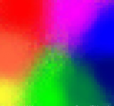

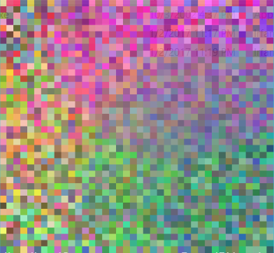

For the specific case of ANNs, boundedness is meaningless; one of the reasons that ANNs are used is precisely because boundaries cannot always be mathematically delineated, particularly so if the input conditions are multivalued, so we're talking n-dimensional spaces that have to be segmented. Moreover, the "features" that ANNs use aren't even necessarily what a human might think were relevant, and that's part of the beauty of ANNs. In classical supervised learning, you simply tell the ANN what you want, and what you don't what, and the ANN tries to figure out what features result in producing that desired segmentation in the training set. Self Organizing Maps (SOMs) are actually trained without supervision, i.e., you let the ANN figure out what it thinks should be segmented. Below is from a demo of SOMs on the web; the SOM takes the random scene and tries to "self-organize" it. This only involves 3 dimensions, i.e., R, G, and B, and it's already complex. The boundaries are fuzzy, and there's no mathematical process for making them less fuzzy; it's just the way nature is.
BEFORE
AFTER
TTFN (ta ta for now)
I just did a MOOC on ML, I found the SOM lessons a bore, but your example is rather nice. Of course one thing with NNs is that not only is their reasoning (late edit for clarity) inscrutable, even designing them seems rather umm, rule of thumby. How many layers? how big is each layer?
