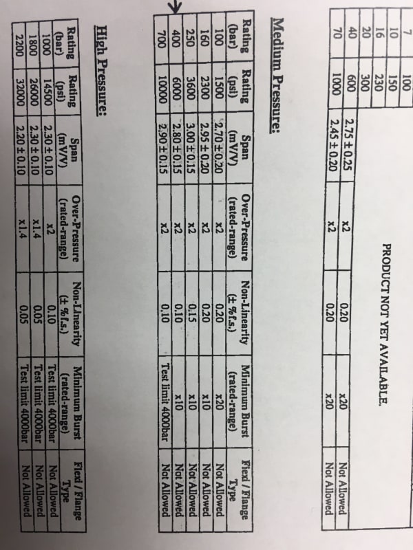

I have a question about a pressure transducer reading that doesn't make any sense. I have a Pressure sensor soaked in water at 125c and 11,000 psi for 24 hours (See images). When bleed off, gauge pressure is 1,000 psi less than sensor pressure. Is there any way that atmospheric pressure cold be reduced enough to give a 600-1000 psi offset pressure that is greater than actual reference gauge pressure? Even if atm. chambers bled to full vacuum how could 14.7 psi increase in sensor pressure from say 5,000 psi to 5,014.7 psi yield a 1,000 psi difference with sensor pressure? Outgassing would create opposite problem as pressure in chamber would increase. Pics of Test Hoohup sketch and cross section of gauge with sensor mounted are attached. I am new to working with electrical components and am learning as I go...
There was a Doe Corning Dieleectric gel applied to wire bonds that is in a gelatin state. Don't see what is can do its so non-viscous and shows no signs of curing.
Sensor Span 2.7V mV/V +/- .2
Vsupply : 10V
Wheatstone bridge mounted on diaphragm of transducer.
Sensor Over pressure is 20,000 psi
Sensor Burst pressure is 58,000 psi
Sensor Rating: 10,000 psi (we exceed rating to serve as safety factor check for gauge and sensor)

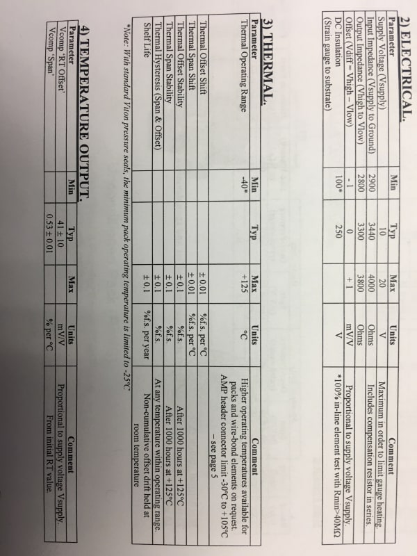

I'm more concerned with the temperature limits - I've never seen, much less used, a sensor that was rated for operation at 125 C. That's getting hot enough to see pretty rapid degradation of silicon microcircuitry. I'd expect to see the output shift with increasing temperature (outside the design compensated temperature limits of the transducer) as well, but it's not clear if that is what you are measuring (what temperature is the sensor when 1000 psi shift is measured?). Do you have a spec. sheet for the device you could share?

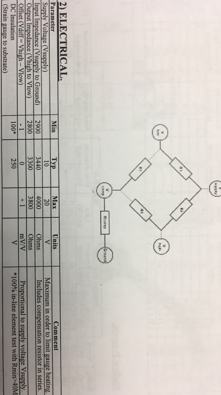

Here are some specs from the unconditioned element, pack and pack assembly. Uses 4 terminal Wheatstone bridge strain gauge with additional 5 th terminal for temperature output. Vsupply 10V. Electrical, thermal and pressure element ad pack tables at coir below.

The transducer in the spec provided is intended to have pressure inside the lumen and against the distal face of the male threaded end, and of course against whatever diaphragm is present. It is clearly not intended to have pressure on the larger face adjacent the pipe threads, nor on the wrenching hex, or basically anywhere proximal to the pipe threads.
Is that actually the transducer you are using, or are you using something more specialized, not yet revealed in detail?
Just curious about this: the data sheet provided as photographs has an inked arrow pointing to the 6000psi transducer, not the 10,000psi transducer.
The transducer documented with a drawing could be used as intended within a machined capsule having a pipe thread through the blind end the 'wrong' way (provide wrenching clearance around the transducer and a long thin socket wrench for assembly), with the other end closed by screwing it into the end bulkhead or an assortment of couplings and nipples to do the same thing.

Explanation of Wheatstone bridge mounted piezo-resistors and diaphragm[/
nearly identical piezoresistors buried in the surface of a thin silicon diaphragm.
A pressure or force causes the thin diaphragm to flex, inducing a stress or strain in the diaphragm and also in the buried resistors. The resistor values will change depending on the amount of strain they undergo, which depends on the amount of pressure or force applied to the diaphragm. Therefore, a change in pressure (mechanical input) is converted to a change in resistance (electrical output). The sensing element converts (transduces) energy from one form to another.
All four resistors will change by approximately the same value. Note that two resistors increase and two decrease depending on their orientation with respect to the crystalline direction of the silicon material.
The signal voltage generated by the full bridge arrangement is proportional to the amount of supply voltage (Vcc) and the amount of pressure or force applied which generates the resistance change. The diagram is EB welded to end of Pressure Transducer Body on CL with hole so pressure can be measured. This is the only location fluids enter the tool.
