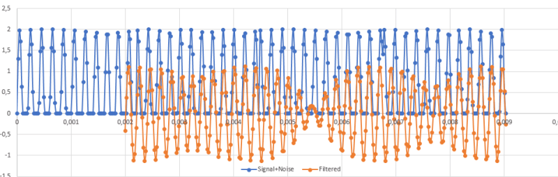

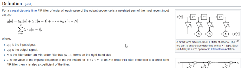

Now, I've seen the math of a FIR filter and also made a spreadsheet out of it. Apparently, it works fine. I tested it by submitting a signal with 6 different sine frequencies and after it goes through the filter, only what's within the passband remains.
But the math of the TIR filter is exactly what I described: the filtered signal intensities are calculated as a weighted average of previous points of the unfiltered signal, therefore mixing up intensities in different times.
For instance, let's think of a very simple AM encoding: half a cycle in full amplitude means 1 and half a cycle in 0 amplitude means 0. If I modulate 10101010101010 etc., my signal will be the positive halves of a sine. If I put that through the filter, it will average full amplitude semicycles with zero amplitude semicyles. The result is that all zero semicycles will be gone in the filtered signal. Not only that, lots of negative values also show up (there are both positive and negative weights, represented as bi in the formula above).
Check out the graph. In the example I used 44100Hz as a sampling rate, a signal of 4900Hz modulated like above (just the positive halves of a sine, the rest is 0). In the filtered signal, all areas of "silence" disappeared, as the maths should have you expect.
Am I doing anything wrong?

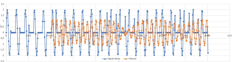

You are right. Maybe that was not the best example I could have come up with. But anyway, whatever are the changes I make to a pure sine wave in the modulation process, they are going to introduce alien frequencies. I tried alternating full waves and blanks as well. Look what happenned.
I tried alternating frequencies. No mater what the signal is, the FIR summation averages out different wave cycles, thus scrambling the data.
So, how is this problem solved in practice?
"calculated as a weighted average of previous points of the unfiltered signal, therefore mixing up intensities in different times"
No, most FIRs are digital models of analog filters. Analog filters have phase delays that are dependent on the frequency; that's what you are seeing. "calculated as a weighted average of previous points" is not equivalent to "average out many wave cycles of that frequency and all the information stored there is lost." If you do the math correctly on each individual frequency you will see that the signal is preserved, but delayed.

What you call "simple modulation" involves multiplying by square wave functions that have frequency content at least 7 times your base frequency, which puts the higher frequencies outside of your passband.

Once again, if you want to to recover a modulated signal, then you need a passband that is at least as large as the largest frequency in the modulation that you are unwilling to sacrifice. The fact that you insist on using rectangular waveforms for the modulation means that you need something like 10x the carrier frequency for a plausible bandwidth.
