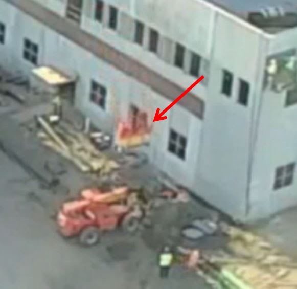

All I can say is, what load?
I see something hanging from the main boom, but not the extension.
I also see no outriggers on the crane.

This load:
faq731-376
Must be a 4x4x8 foot block of gold...
Mike McCann, PE, SE (WA)
Mike - it was a crawler crane.

Looks more like it was set up to lift stuff for the units which are at foundation level and used out of reach.
Looks to me like nothing happened other than overturning the crane- no brake failure, no jib failure. And in that case, just a matter of getting the load too far out. Possibly coupled with wind.

It was a scissor lift.
Doesn't look like a lot of counter weight on the crane though and he was lifting 90 degrees to the tracks.

...the pics aren't bad. One shows the lift number which after quick google search, returned 4635 LBS weight so quite a bit more than 1000 lbs quoted in the article.
Maybe 1000 lbs is what they said to the crane operator....
