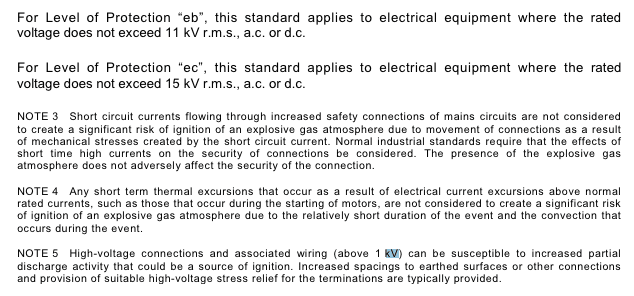

Someone said to me that IEC 60079 is for the low voltage. For high voltage it may not be fully applicable. Would you throw some light on this as well?
Hi Krisys,
It is not correct that IEC 60079 series of standards apply only to low voltage equipment.
See excerpt from IEC 60079-7 below.
This is just a snippet, there is probably more in that standard that applies to your application.
Regards,
Michael.
