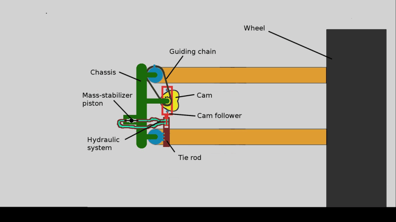

STABILIZER DEVICE.
When a vehicle takes a curve, there is a transfer of the weight of the inner wheel to the outside, producing the inclination of the chassis.
On the other hand, in a hydraulic press with great difference of size between the pistons, it is easy to support in the small piston the load located in the large although this one is variable.
Applying this principle, it would be easy to avoid tilting the chassis by a small compensating force.
However, the suspension is also affected by the movements of the bumps, which makes it impossible to implement the press.
The mechanism that I propose is able to maintain a constant separation between the chassis and the suspension regardless of the movement of this one.
Another more complete form of exposition is the following:
When a vehicle is traveling in a straight line, the spring-damper assembly ensures that the wheels copy the irregularities of the track to improve grip and comfort.
When accelerating, braking or passing through a curve, there is a variation in the length of the spring as a consequence of the transfer of weights, having an undesirable effect on adhesion and comfort.
To minimize this, the stabilizer bar which is used introduces a force between the chassis and the suspension to avoid adverse effects.
The problem is that they act as a suspension lock to avoid rolling, but do not discriminate bumps and transmit them from one wheel to another on the same axis unless it affects both equally, as in the case of soundtracks . This results in loss of comfort and grip when the suspension is not released freely.
On the other hand are the suspensions with the active sway bars, which through the management of an automaton and a pump, introduce the necessary force to minimize the movements, having the disadvantage of energy and economic cost.
The mechanism that I invented introduce a force between the chassis and the suspension to be able to manage the inclination and the pitching with zero or reduced consumption, but without the bumps transmitted from one wheel to another.
The device that allows a constant separation between the chassis and the suspension is based on the irreversible mechanisms of transmission of the movement, which are the cam-follower and the screw spindle-nut.
By connecting one end of one of these mechanisms to an arm of the suspension and actuating the necessary amount as a function of the displacement thereof, it can be achieved that when the suspension rises, the device cuts its length and vice versa, when the suspension descends the device is extended.
This is intended to have two surfaces, one integral to the chassis and the other to the suspension, separated the same distance regardless of the position of the suspension arm, and can introduce a force without work. Taking advantage of this feature, with a small control force, generate a larger one that acts on the device and therefore on the suspension.
In order to produce this force you can choose between different mechanisms, one of the most suitable being the hydraulic one, which will consist of two pistons of different size. A large one that will be located in said gap and will cause a pulling force or compression between the chassis and the suspension. The other smaller one will be located where it is desired and will be with the one that controls the device. The greater the difference in size between the two, the smaller the force required on the small piston to obtain the desired one on the other and therefore on the suspension.
If one chooses to use a screw spindle (Figure 1), to be irreversible must have a high ratio, so much must be multiplied the movement that makes it spin depending on the suspension.
As in this case only the property of irreversibility is interesting, unlike other applications the problem can be solved by implementing several screw spindles in series connected by nuts, so that nuts and screw spindles are alternated. The more you put, the less the multiplication of the necessary spin.
You can choose to rotate the screw spindles, nuts or both.
If you choose the cam, unlike common applications, it will not be associated with a rotating shaft but the reciprocating movement of the suspension and a rotation less than 90 °. For this reason, among other options, it can be done by combining on the same axis two disc cams sharing follower (Figure 2).
According to the above hydraulic model, in the control device acting on the small piston to replace the functions of the stabilizer bar, a mechanical variant based on a mass can be chosen, as in the attached figures 1 and 2, which is pushed by the centrifugal force to compensate for inclination in bends.
However, given the current state of the art, it can be run economically and more accurately by means of automatons equipped with sensors such as accelerometers and inclinometers.
Finally, the mechanism that moves the device, either the cam or the screw spindle, is missing depending on the movement of the suspension. Different transmission methods may be used, one of the most suitable being the use of cables or chains as the guiding chain of Figure 1, since it is a small-stroke alternative movement, although it is necessary to use one for each direction of rotation of the suspension.
FUNCTIONING:
In both embodiments the suspension bushing moves by rotating the gears of the link, causing it to rise or fall.
In figure 1 the guiding chain will move the cam and this will move the follower the same amount and in the same direction that the link has made to preserve the distance between the axis of the cam and the link. That is, what goes up the link goes up the follower and vice versa.
In figure 2 it is not shown for ease of understanding, but a mechanism such as the guiding chain will also move all the screw spindles, either all the nuts or both, together with the rotation of the bushing, so that they are joined or separated with in order to obtain the same result as in the case of the cam.
In both figures the linkage is separated from the follower or the screw spindles by the hydraulic circuit, which according to the centrifugal force pushes the regulating mass in one direction or another, will cause the desired force of traction or compression in the device.
EXPLANATORY VIDEO: For a better understanding in the accompanying video, I has been used a lever to extend the corrective force instead of a hydraulic system or of gears that are more practical in the reality.
In the video the idea is appreciated by acting first when riding on a bump, where the device does not interfere with the suspension in the same way as a vehicle without stabilizer bar, which is ideal in that case.
The vehicle is then traversed along a curve without the device acting, with the inclination of the chassis being appreciated.
Finally it is activated so that it generates a force that prevents the inclination even if it passes over an irregularity.

If this is your idea that you would like to patent, perhaps the above text should be reserved for your patent application, because now that you have placed it in the public domain, you can't patent it anymore.
But ... You probably won't be able to patent it anyhow, because it has been done before, not necessarily using the exact same mechanisms, but functionally comparable. A simple Google search turns up quite a number of hits.
There are much easier, simpler, and more robust ways to do it than what you've shown.
One simple way is to just replace one end link with a hydraulic cylinder, thus allowing the effective length of the end link to be varied. No cams, no chain drives, no exposed threaded mechanisms. Bear in mind that this mechanism has to survive sand, mud, salt spray, and the like. Exposed chains don't like that. Exposed cam mechanisms don't like that. Exposed threaded mechanisms don't like that. Piston rods with sliding seals (and often covered by a protective boot) ... that, we know how to do in a way that will survive; every standard damper has the same situation.
I know that there are offroad vehicles in which antiroll bars can be disconnected during offroad driving (for better articulation on highly irregular surfaces) and reconnected for on-road driving (for better handling). They do it by essentially locking an end link to a fixed length or to unlock it to allow it to float (which renders it unable to transmit any force).
Another way is to replace the entire spring and damper mechanism with one having some type of active control. Look up Citroen hydropneumatic suspension ... they did this in the 1950s. That there is no Citroen vehicle produced today that still uses this system ... might just indicate that the benefits weren't worth the significant cost and complexity and failure points. British Leyland gave up on Hydrolastic, too (and yes, I know British Leyland eventually failed as a company, but no one else uses it, and the patents have long expired)
So your next challenge will be explaining why your proposal is better than what's already out there - including why it's better than what's already been tried and given up on.
I should add that it is a very rare case when passing an antiroll bar from one side of the vehicle to the other presents a great deal of packaging difficulty.
Both vehicles in my driveway have the front antiroll bar across the vehicle in front of the powertrain underneath a subframe crossmember that has to be there anyhow. One of them doesn't have a rear antiroll bar. The other one has the antiroll bar inside the twist-beam.
There's no point trying to solve a problem which is nonexistent in the real world.
My personal favorite was a hydraulic system 'powered' by bleed-off from the hydraulic power steering valve. Now with electric steering and with rollover attenuation, controlling roll VELOCITY is the dynamic variable to be managed. Just some cross coupled air hoses do a nice job with level control. Tuned with orifaces for the roll frequency you want to manage.
While we're on sta bar disconnectors there's three other contenders. Jeep use a dog clutch in the centre of the bar. LandRover use a hydraulically locked ball screw in the centre of the bar. Somebody uses an electric motor plus gearbox in the centre of the bar. The advantage of the two latter methods is that you could do some active shennanigans with them. Hydraulic drop links need a lot of packaging room if you are going for total disconnect.

Thank you everyone for your answers.
Sorry for the delay. I will try to answer all the questions.
Your are right it is not a new idea but a different way so is categorised like utility model. It is patent pending but I am not completely sure if it works.
Some of low performance vehicles have no rear sway bar because of the small forces in this axle but most of cars use it.
Disconect it and drive around a curve. You will notice the difference.
I know active sway bar of Porseche PDCC, BMW Dynamic drive, Citroen SC.CAR, Audi eARS, etc.
One of the most impresive result is Citroen Xantia Activa 2 a family sedan of 1994 which is faster in cornering than expensive modern sports cars.
The purpose of video and pictures is to show how it works. The device will be compact and protected by a casing if it would mass produce.
Moreover I think is better the screw mechanism than cam because of the size.
I think my idea is easier than mentioned active sway bars because no need introduce large forces (about 100 times less) for avoiding tilting with high pressure hydrulic o pneumatic devices o electric engines. If the device is built with the screw-nuts will be slightly larger than connecting rods.
