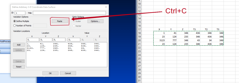

I'm trying to import external data (temperature field defined as node location with associated temperature) to mesh which is not same as external data. Is it possible do that in Femap environment?
Best regards
JK
You can use Data Surface tool. You can map results from other mesh with option "Output Map Data Surface" or paste temperature and coordinate data from text/excel with option "Arbitrary 3-D Data Surface".

it works.
But I have another question. Is it possible to load data of multi columns? Eq. I have x, y, z coordinates and then n columns of temperature data and I want to load them in one step. Or I have to load each column of temperature data separately?

Try this algoritm. Also you can experiment with format of text file - maybe separate columns with space and use equal column lenght to copy directly from text file.
think I wrote it not exactly. Each column of temperature data means different time step. So I have (x,y,z,n-1,n,...,n+1) and I want to only change specific column of temperature data for my study.
But I think it is not possible and I must load each temperature data separately or write some script.
Does anybody have experience of load huge matrix of data (4 columns and 100k rows)? In my test study it takes approximately 10 minutes one data surface.
