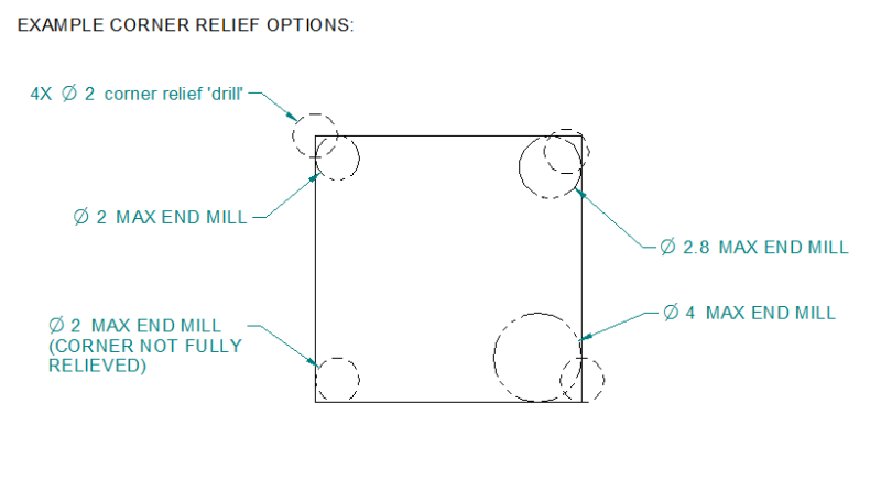

Valmeidan, here is a sketch showing some corner relief options I've used before to maximize cutter size while allowing for a 'square' mating part.
They don't allow for tolerance etc. but illustrate the point hopefully, in each case let's assume the corner was pre drilled by 2 mm bit before machining the pocket - only location varies.
Now there is no free lunch, the more of the 'square' wall material you remove the less you have to resist the Brinelling from your square drive etc.

Oops posting at the same time Mike. I didn't mean to imply you have to remove all the material with the 2 mm bit, just that you're left with finishing up the machining with a bit of that size.

Is your primary load in one direction, or is torque similar both directions? The corner relief I showed bottom right can work OK in unidirectional applications.

304 stainless should be strong enough, essentially it will be fitted into place then wont be taken off, nots sure of exact torque, the handle that came with the valve is pretty tough to turn. The load is rotational 90 degrees on y axis clockwise or counterclockwise depending on the flow direction. So your saying 2mm not corner relief just a radius is better then the relief in the top right which is what I am using now? in your bottomr right pic the hole is tangent with the bottom edge but offest right

"So your saying 2mm not corner relief just a radius is better then the relief " - no, your other bottom right.
