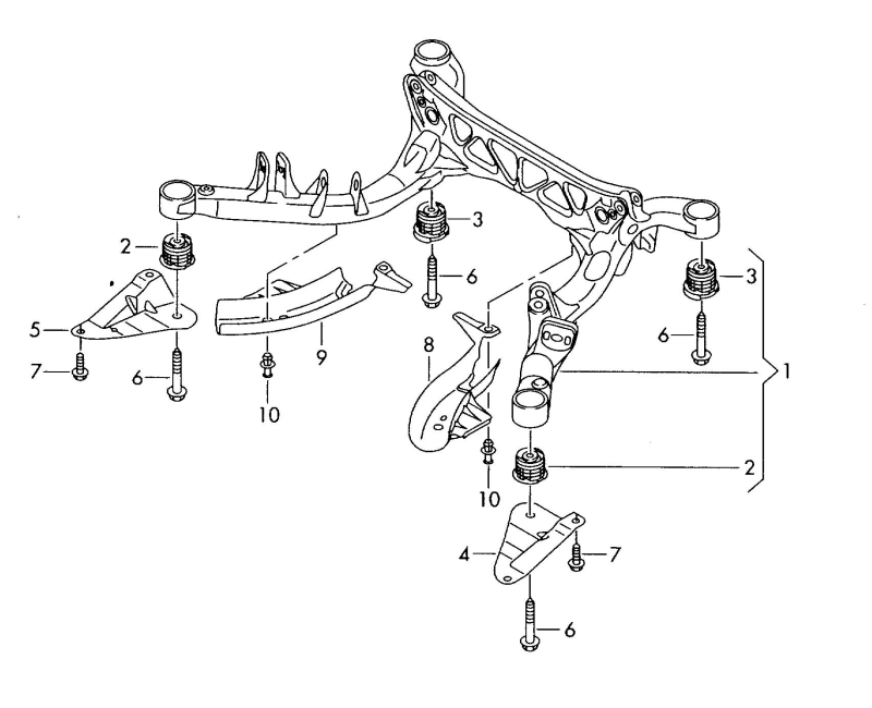

The part to be measured is similar to this one: The A reference is bottom surface of 4 bushings at the edges(A1 A2 A3 A4) in which number 2 and number 3 elements go. B reference is a hole next to one bushing on the left and C reference is a slot hole next to the other bushing on the right. So do I have to use these features to align the part in the fixture? If yes, how will CMM measure those holes if there are pins inside? Do I have to remove the pins once the part is fixed? Or does my fixture have to be enough accurate that if part goes in, I assume those holes are in tolerances?
About the granite block I am not sure yet if I can attach the fixture since the CMM is not in our plant but in customer`s. I am waiting answer from customer about it.

OK, so I think I should use one pin in the B datum hole, another pin in the C datum slot hole and 4 Z supports under 4 A datums and clamp the part only on 3 of them, otherwise the part might bend. Maybe I should remove the pins after clamping, I will discuss this with customer.
KENAT, I am new to CMM and also not experienced in gauging. But we are not the one who is producing the part. it is some other manufacturer. We will only design the holding fixture for CMM.
Another question: where is CMM`s 0,0,0 point? how does it zero itself regarding to the part?

I am not sure but I think these can be two of the reasons why they need a fixture: 1. Because there are also features to be measured under the part, if you put the part directly on the granite, you cant measure them. 2. (even though I find it weird) Some customers want to measure the part as it is assembled to the car. So when it is clamped.
Quote (HGMorgan)
As far as holes vs pins, the CMM can survey either one: 4 pt's on outside of a pin or 4 pt's inside an ID.
We don't normally use pins because of pin to hole fit deviations.
I was thinking about this one but I thought they wouldn`t use this method because of the reason you said. You lose accuracy because of the fit clearance. Could it be possible to remove the pins with a sliding mechanism after the part is clamped?
Quote (HGMorgan)
As far as the RPS6 +/- 2mm, that sounds like "designated restraint"(ENG is telling use how to restrain the product),
I.E.; clamp RPS3,4,5 on 2mm block(those 3 points should clamp flat) and RPS6 can range from touching surface table, to up to a 4mm gap from table.
I think this is good solution.
Quote (HGMorgan)
Impossible to say for sure without review of drawing.
Unfortunately I am not allowed to share the drawing.
