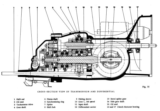

Question: I have a Porsche transmission pinion bearing race going into an aluminum housing. On top of this roller style bearing is a four point ball bearing and then a steel retainer plate. The problem with these transmissions is that the pinion race creeps over time and sooner the pinion race becomes real loose. Mine had .002 clearance. Some have quite a bit more and can wobble in the bore. The common fix is to machine the housing and press fit a sleeve and then the race. This takes a lot of meat away from the upper bearing, the main shaft bearing. The other alternative is to electro-plate the OD race and then sneak up on a clearance, which is the route I've taken because it was cheap (nickle plating). My question is fit. My housing is 3.151". My bearing was 3.149" OD and is now 3.154" OD. This bearing is FAG, special bearing, impossible to get information, $600 list ala Porsche -- basically a black hole. I believe this bearing takes the radial load from the pinion and the other takes the axial. The bearing race is .904" wide. The other smaller main shaft bearing appears a tight press fit, and I am not touching it to see how tight. The pinion bearing race (to the best of my knowledge) is not a slip fit by design because the factory manual says to heat up the aluminum to 120c to get it out. I think that I have covered all the information needed for the pros to give some advice on the matter. Any info on fit is appreciated.

The pinion gear bearing mounting you describe (cylindrical roller and split race ball bearing) sounds like the one in the drawing below. The roller bearing takes radial loads and the split race ball bearing takes thrust loads in both directions along with some radial load.
The fit between steel bearing races and aluminum housings is always problematic. Unless the bearing race has an adequate interference fit at operating temperatures then the race will creep/spin in its bore causing excessive wear. If there is too much interference fit at RT, then there is the possibility that the bearing will lose its internal clearance at low temps due to CTE mismatch between the race and housing, potentially causing seizure of the bearing. Thus fits between steel races and aluminum housings must be carefully considered.
Since your pinion gear roller bearing is subject to fairly high radial loads, and these radial loads will change direction as the car accelerates or downshifts, I'd recommend sleeving the housing with a similar material and re-boring to the factory specs. Unfortunately, this would also be the most costly solution.
Using an anaerobic adhesive (like Loctite) to "bond" the loose fitting race into place would not likely be a reliable long-term solution in this particular instance. Loctite only has a shear strength of about 3 or 4 ksi and does not work well as an adhesive. Instead, the most effective use of Loctite is to increase the coefficient of friction at clamped joint interfaces.

You nailed it with that drawing, and I thank you for the detailed reply. You also know exactly how the bearings function. Both the bearings on the pinion shaft are clamped down with a steel retaining plate which also clamps down the same bearing setup (though smaller) on the upper main shaft. The problem with the steel insert and re-bore, it takes away the meat between both main shaft and pinion shaft. This is what I am trying to avoid. I have the race plated over-sized and can sneak it down to "a size", so I presumed, naturally, that there was some standard to go by, at least for transmissions. The factory calls for a temp of 120c to get it out, so that can be .002 - .003", theoretically. A temperature number to get it out is all I can get out of the factory manual, no bearing fit specs whatsoever.

patprimmer is correct regarding the "septum" area between the bearing bores. The opposing gear forces will mostly cause the two roller bearings to separate, and the septum area will be lightly stressed. The only issue would be if the septum gets excessively thin it might yield during the thermal fitting of the races, but that would be an extreme case.
I would stay away from welding except as a last resort, due to potential thermal distortions. However, there are companies that specialize in thermal spraying metals to salvage slightly worn component surfaces exactly like yours. Thermal spraying doesn't put as much heat into the part as welding, so distortion is minimized.
If there is concern about the thickness of the septum with over-boring/sleeving/re-boring, and the existing bore is only a couple thou' oversize, you also might be able to find someone that can lightly knurl the bore surface. This would raise the surface slightly and then it could be align bored/honed back to spec. The knurled & honed bore surface would probably even give slightly better wear than the original aluminum surface due to the mechanical work hardening effect from the knurling.
