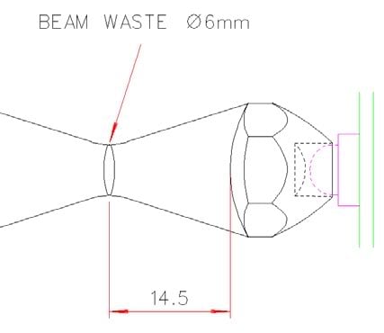

I am looking to focus:
(3W PROLIGHT HIGH POWER RGB FULL COLOR LED 120 LM
Viewing Angle:120 degree, the led is self (not the board its attached to) is Id r2.95mm, OD r4mm)
Into a 0.25in beam from 12ft away.
With as few lenses as possible and cost ratio.
A bit of loss is to be expected but no more that 15% power can be lost. 20% would be absolutely pushing it.
the closest thing i could find was and this one:
This one has the size i need of 6mm but would need a second lens to stop the beam from diverging.
I am programing up a display system, using high speed galvos and lasers. I was able to learn enough to get them running but the leds i need to have a way of focusing them. i have a few lenses but they are in use as the lasers need them and i am unable to get them out at this point.
I am starting to go my budget due to frying a few lasers and a small programing mistake, and for the sake of my sanity i was hoping someone might help me with the final optics for the leds.
Just point me in the right direction of what i need to buy and align.
At this point I like the optic with a 6mm focus but i don't know if i need a single or double convex lens or a concave lens or gods know what else.

How clean of a beam do you expect at 12'? You said 1/4", but how clean do you expect the edge to be at that distance? If it needs to be sharp, you may need a mask, adding to the complications. You can't make an LED have the same characteristics as a laser beam just by shining it through optics, so there are shortcomings you may not yet be aware of.
If you expect any more useful help, you'll need to be specific on what you're trying to accomplish (and the budget you have to work with).
Dan - Owner
A pic i drew up to help me, thought it could help other understand what i am thinking.
As this is only being used for a display the edges are not expected to be crisp. if a dot at 12' size of 1-2.5" then had a bleed or splash of about 1" maybe even 1.5" on top of that it would be fine.
Other than that i am unsure how to get more specific.
I have changed my orginal goal of .25 as i think that is unrealistic to the cost.
after talking it out 2.5" is the new max for 12'
I went to the Prolight site and I'm a little unsure of which LED you are using. There is a 3W p/n PG1M-1LFP-3 but it is three individual LEDs in a 24mm circle; there is also a .3W PPGN-TFFE (note the order of magnitude difference in output). It would be beneficial to know which LED you are using for prototyping and if that is what you will be using long term in order to make a rough model.

I played around with this a little as time would allow and there are a few things that really get in the way of my resolving your question. The most important would be as Dan asked, what are you trying to accomplish? I know you want a tight spot at 12', but knowing more about the application would help.
The other issues I ran into that could be addressed with more time are that the LED you selected does not have downloadable IES files available (meaning I have to model it which I did), the optic does not have a file availble (I'd have to approximate that which I did), the ProLight LED is phyically different enough from the Luxeon that the optic will not work as it is drawn (close but not quite), and the LED actually has a half angle of 140 degrees and an included angle of 160 degrees which will make a difference as compared to your expected 120 degrees.
I was having fun but I just don't have that much spare time. If this is really a significant project and opportunity for you I would suggest you track down a lighting/optical designer and spend the money to do it right. The Photonics Spectra Guide should have a ton of references for a start.

Note that 2.4 inches at 12 ft is just under 1 degree. The POL lens, when matched to its Cree LED is actually only nominally 5 degrees at FWHM. Interestingly, the Intensity Distribution graph in the POL datasheet is lopsided; it's 50% at 2.5° on one side, but ~63% at 2.5° on the other side. The POL optics are actually Cassegrains, and not a simple optic. You probably need to talk to POL about a custom optic.
I didn't see anything comparable on the Edmund Optics website.
