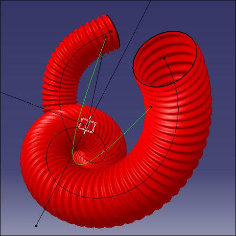

Another interesting Law-Sweep combination is when there is no obvious way way of constructing a particular curve. A curve that may be seen everyday - and not noticed; a simple, coiled air hose, like those between a truck and a semi-trailer (8).
How to model one in Catia V5 with the Helix Curve tool isn't immediately obvious (in R14 anyway), as the axis has to be linear. But, in Sweep, a helical surface can be wound along a curve, it's outer boundary saved, and the surface hidden.
(8) (9) (10)
Open the Sweep tool and find the With Reference Surface option (9). There are two versions of this; one uses an existing profile (line or curve), while the second uses an implicit line, which is normal to the axis. You just enter the length of it. The guide curve, in this case, is the conic; the reference surface is something to start the angle of twist from.
Disregard the Angle and select Law, then select Linear. The Start value remains at 0, the End value (10) defines how many turns the helix will have - I'd start at 360 degrees and see if it's going to work (11) . Then edit the law to give the number of turns required. You don't have do any sums to find out how many degrees there are in so many turns - just enter "360*n" (number of turns) - it'll work it out (12).
In fact, any of it can be altered later - I tend to get something like this functioning first, and then fine tune it.
The implicit edge of the sweep can be used dirctly as a guide curve for the other sweep, but I prefer to use the Boundary - I think it's better practice...(13)
(11) (12) (13)
In the last picture a black helical curve has been wound along a green parabolic conic, and a circular sectioned, corrugated surface formed on that (14) - a Case of Law on Law...
I doubt if the need to model hoses, etc is likely to happen very often; this is all about a modelling method and practice: these are a few of many examples of Laws controlling Surfaces.
