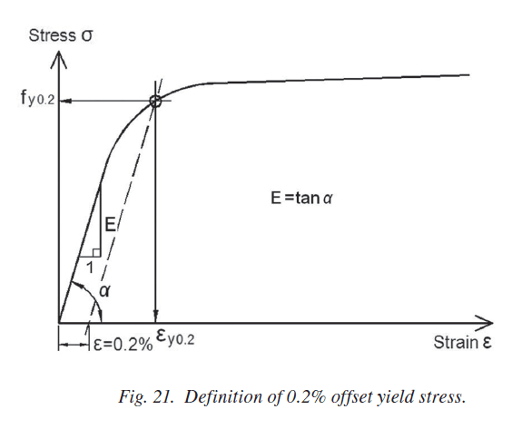

There are different ways to determine yield strength and elastic modulus (see various ASTM standards).

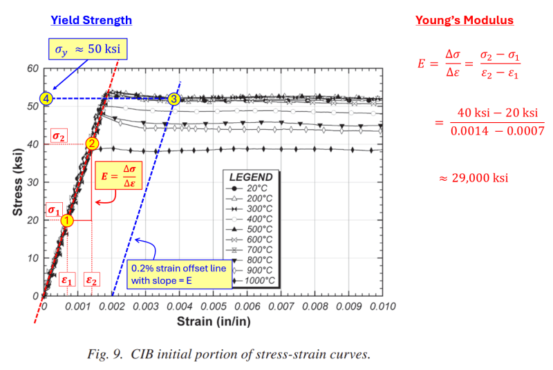

Yield strength is commonly determined as the stress at which a 0.2% strain offset line intersects the stress-strain curve. I believe this is how it has been done by some for A992 (e.g., see the article mentioned above by 3DDave:
Bartlett et al. (2003), Updating standard shape material properties database for design and reliability. Engineering Journal, 40(1), 2-14.)
Young's modulus, E, can be calculated as the slope of the stress-strain curve in the linear region.
Below is a schematic diagram showing how to determine 0.2% offset yield strength and Young's Modulus, E:
And here is an annotated (by me) A992 stress-strain curve and corresponding example calculations (the stress-strain curves below are for A992 after various thermal treatments, I used the room temperature curve):
Figs. 9 and 21 above are from Lee, J., Engelhardt, M. D., & Taleff, E. M. (2012). Mechanical properties of ASTM A992 steel after fire. Engineering Journal, 49(1), 33-44. I added the red and blue annotations & calculations to Fig. 9.
