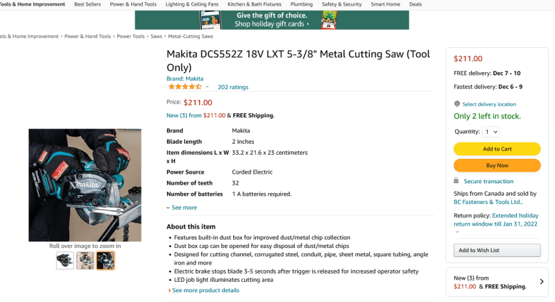

Try one of these:
Metal Cutting Saw
Screenshot_2021-12-01_at_13-04-12_Makita_DCS552Z_18V_LXT_5-3_8_Metal_Cutting_Saw_Tool_Only_Amazon_ca_Tools_Home_Improvement_y61mv3.png
Wear full PPE. Consider a hood.
A steel chip, ricocheting several times and hitting the back of your ear is painful.
Use the metal cutting blade with teeth, not an abrasive blade.
The toothed cutting blade cuts very much faster and will leave less debris inside the tank.

How thick is that wall? Is there typically some clearance between the wall and the transformer? If so, power sheet metal shears or seat metal nibbler starting from a drilled hole will preclude the creation of metal chips and not generate high-velocity debris.
I believe there is generally a gasket present between the interior and the weld. This avoids debris in the tank during assembly as well as disassembly. To be sure, you might check with the manufacturer.
