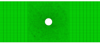

I'm trying to model a composite test coupon damage combining LaRC05 criterion and XFEM.
To get my job converge after first element experienced some damage (STATUSXFEM between 0 and 1, usually at 0.4) I had to define damping factor of 0.0002 in the Step module (completely eyeballed this value based on some superficial reading some time ago - constant throughout the analysis).

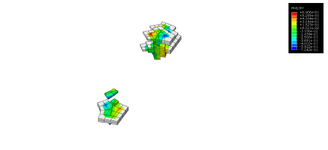

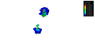

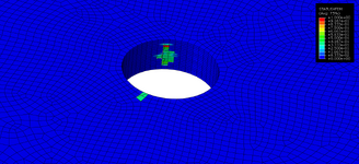

That enabled the model to converge but ended up with an error: The system error in std_findcutshape3d8_xfem -- nodal level set values might not be correct for element 85606 instance part-1-1, its philsm are -1.85580e-02, 0.17272, -3.78320e-02, -0.20095, 8.42569e-02, -0.27117, -5.87143e-02, 0.27912.
This model had 1 enrichment zone per layer.
I tried softening displacement amplitude, refining mesh, and making enriched zone smaller and defining 2 enrichment zones per layer (above and below the hole) but nothing really helped.
Is there anything else I could try that might help my model converge better or faster? Pictures attached are the first model with the error mentioned. mesh.pngphiIsolated.pngxfemFull.pngxfemIsolated.png

With ANGLEMAX = 15 upper part of the crack connected nicely, while the lower part (even though its symmetrical layup) hasn't and that caused the original error. As the explanation of this parameter in the manual is a bit vague I'm not sure how the angle defined is measured.
Did you try different values ? It's the angle between the subsequent crack propagation directions.
If it doesn't help, I would try changing the mesh.
