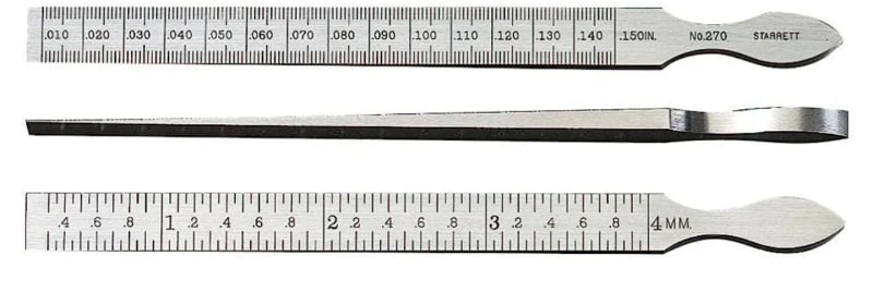

The primary purpose of the assembly is a go-no gauge to check vinyl extrusions for inner wall form by inserting it into the end of an extrusion and noting how far it goes. Optical scans of cross sections are also done at a lesser frequency.

The.00025 is the tolerance of each tapered hole in the steel base to its corresponding steel tapered shaft, in order to achieve a light press fit.
In my representative model, the .1 offset used to create the taper is driven by the vinyl profile tolerance. In this example the vinyl's tolerance zone is slightly less than .1, so that the gauge's range slightly exceeds that tolerance. The 30 to 1 taper angle magnifies the tolerance, like a wedge gap gauge.
Karl
Karl,
I get the picture and am far ahead of you. Those Starrett gauges are for relatively harder metals than vinyl that have similar thermal expansion coefficients. Vinyl will easily deform and small temperature changes will produce large comparable variations. It's tough enough on a single feature, much more difficult on a group.
Just put 3X [profile | .0001] all over on the exposed surfaces. (The "3X" is the secret handshake that all the surfaces are simultaneously meeting profile and location at the same time.)
