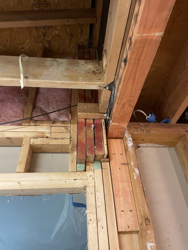

Well, along the same line of thought, this is one I ran into today. This is the end of a triple truss girder spanning 23 ft. and supporting the rear of the house (9.5k calculated design load). It has been like this for 15 years. The best part is, it is literally sitting on the subfloor with no foundation below it.
Now that is some redundancy.
I have no idea. Maybe not even nailed together?
Maybe it's just the picture playing tricks on my eyes, but it looks like that double plate is deflecting. I also love the shims. Why couldn't they frame all the studs to the same height. Mind boggling.
It def. is deflecting.
I'm having them put a 3 1/2x7 PSL column under it and a 6x6 on a footing
