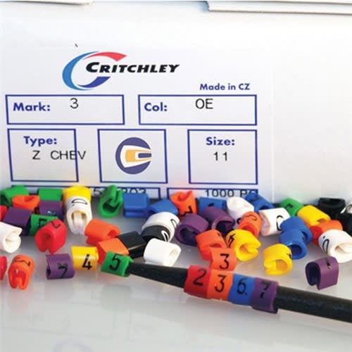

if colour coded numbers are used you can read the colours. you always read from end of wire. so 123 would be brown, red, orange if you read it wrong it would then become 321.

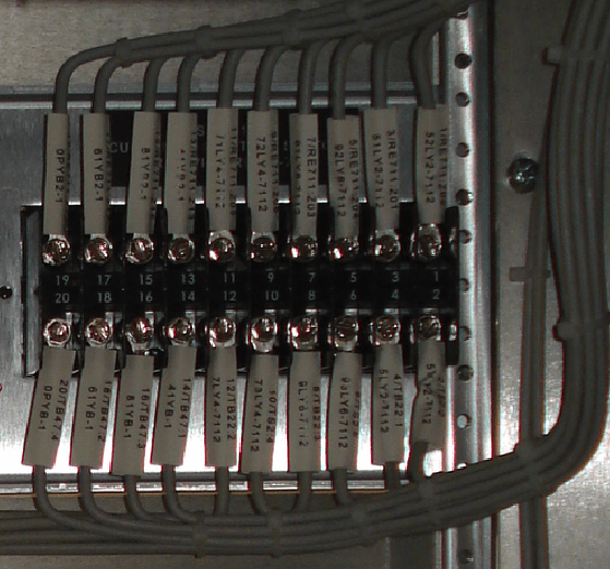

For us it depends on the customer preference. Some customers want all of the point to point vertical wire markers going the same direction so they don't need to turn their head to read the top and bottom switch connections. Others want the "from" terminal number to be closest to the terminal, which causes the top terminals to read up and the bottom terminals to read down. In this example they are all reading top to bottom.
Those cable markers in JG2828's photo are a creation of Satan: they become brittle after a few years, the print fades and they crack and fall off. Maintenance nightmare! [curse]
The Critchley Z type are fantastic, the numbers are inherent in the colour code even if the print wears off.

just read the colours from termination end does not matter where it is installed or just laying lose.
the printed black on white does rub off and not always easy to read with no light when you got your head stuck in a panel.

ScottyUK,
I have used some wire markers in the distant past that rub off (dot matrix printer) and eventually crack. The ones pictured are actually very durable. They are Panduit "military grade" heat shrinkable labels that use thermal transfer printing. I've been using them for the last 12 or so years with no issues. They are used on indoor relay panels, so I don't know how well they would fare outdoors exposed to sun and UV rays.
That's interesting - Panduit's stuff is normally pretty good. The ones I recall were early 90's vintage and were falling apart within 10 years even in a nice controlled indoor environment. Visually very similar, presumably very different in quality.
