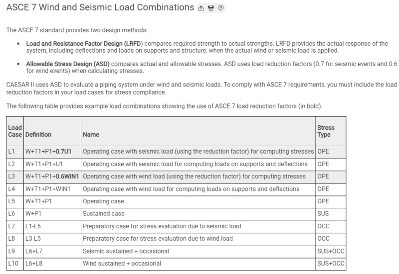

I am starting to design the foundation to support the pipes. I have uploaded the load combinations posted by the equipment vendor. They are using ASCE 7-16 for wind load. By looking at the load combinations, I think they are mixing allowable with ultimate. ASCE 7-16 wind is ultimate or strength level. The weights of the pipelines are allowable (correct me if I am wrong.) Thus, the load combinations presented is not valid because you could not mix allowable with strength level load cases. The operating condition of should have a 0.6WIN1 and 0.6WIN2 load factors. Then the load combinations are on the same level. Your input is much appreciated.
 https://files.engineering.com/getfile.aspx?folder=32553b11-cac1-4def-8340-3ae03870f014&file=All_Load_Combinations.pdf
In any normal world. The fabricator lists the actual (nominal) weight. This should be taken as D for either LRFD or ASD load combinations.

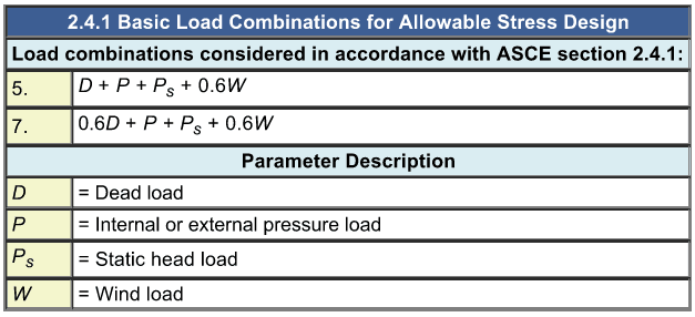

To bring the nominal weight into the load combinations, if it is dead weight the factor would be 1.4? In the attached document, for load combination #46, the correct load combination should be W+T3+P2+0.6WIN1? So is load combination 48, there should be a 0.6 factor associated with all wind loads.
In COMPRESS Pressure Vessel Design Calculations, they actually show this:
Mixing up strength level and allowable stress design load factors are not allowed as far as I know. That is just the very basic.
They specified at the top of their combinations that WIN1 and WIN2 are ASD wind loads. TO me, this says they already multiplied the wind load by a factor of 0.6 and that is why it is not showing up in the load combinations.
