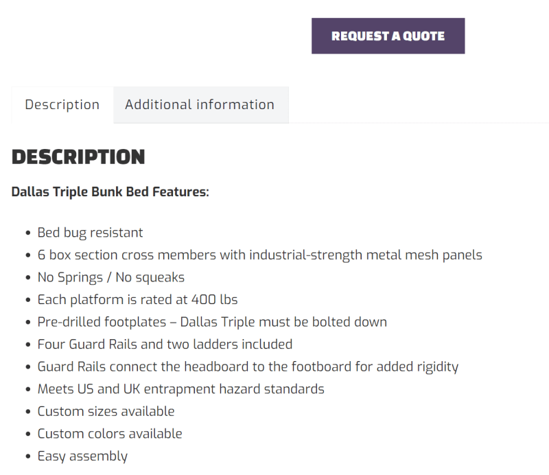

The minimum load (unknown if that means rated or design limit) for "sleeping rooms" (according to the IBC) is 30 psf. Let's say that the weight of the heavy-duty steel king-size triple bunk bed is 400 lbs (very high estimate), all 3 king-size mattresses are each 180 lbs (highest amount for commercially produced ones), and that all 3 mattress topping sets are comprehensive and are each 30 pounds (extremely high estimate). This means that the bed setup has an overall empty operating weight of 1030 pounds, which is the same as the curb weight of a 4-seater golf cart. A king size bed has dimensions of 76 inches by 80 inches.
Let's also give an aisle on one side of the bed so that people can get on without passing through other beds. Let's make the aisle have the width as that in a school bus, which is 12 inches. However, the aisle is shared between facing beds, so that the aisle width per unit cell is only half that. Assume that each bed corner support post is 2 inches by 2 inches (fairly small estimate). That gives a bedset unit cell of 86 inches by 84 inches, which is an area of 7,224 in^2 = 50.16667 sqft.

I think the bed post will go through the floor first...

@LittleInch But what happens after the post goes into the floor? Anyway, such heavy duty beds will definitely have widened bases to make the load concentration only a small fraction of what it would be otherwise because the designers know about the problems that it would cause. People pass by the end of the bed by passing into the adjacent unit cell's half-aisle. Also, how would there be problems such as food, sanitation, and HVAC? Those housing units will still have all the wet rooms unaltered and fully functional. For cooking, they would just use a huge pot for every dish during every meal (prepared for the entire day) and all eat the same food just like a restaurant, exponentially simplifying the task and making it similarly more efficient. To shower, they would just take turns on a routine schedule and take several hours between the first and the last person, maximizing the utilization rate without overloading that one. Also, since they are so close together anyway, the shower stall will be widened and each mattress-mate will shower 3 together, dividing the time in 3. When they're sleeping so close together and are such close friends anyway, they'll almost certainly sleep naked together at least ocassionally, and the 9 men within each shared bed will soon become gay and decide to call themselves a family.
@Tomfh Also, what if the bed were instead 200 pounds, each mattress 130 pounds, and each bedding set just 10 pounds (these are all typical values) meaning that the bed operating empty weight is 620 pounds? This gives a total loaded load at 2,690 pounds, which gives a load concentration of 53.62 psf. Will that then likely lead to a collapse or not?
