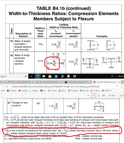

I have been working on a spreadsheet to design monorail beams with cap channels.
Which My value should I use for case 16 in Table B4.1b? (Myc or Myt)
My instinct is to use the yield moment for compression (Myc) since hc is regarding the compression flange. Agree?
Also, when considering flange local buckling of the channel for weak axis bending(global), would you consider case 18 (Flange cover plates case) of B4.1b or just consider case 10 (Flange of channel)?
