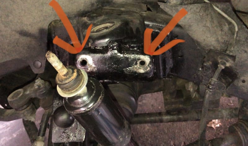

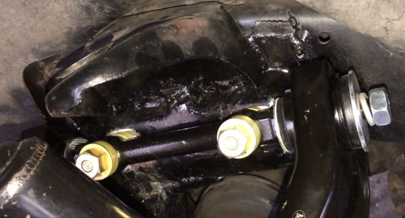

Hello,
This question is regarding strength reduction in an upper control arm pivot shaft on a 1996 Nissan Hardbody 4x4. The stock holes in it to mount to the frame are 14.3mm in diameter and the stock bolt size is m14-1.5 I discovered someone had drilled one of the holes out to 16mm to drill and tap the frame-side threads to m16-2. I have included a photo of the shaft and the hole on the lefthand side is the widened hole. Do I need to worry about the shaft being weaker and possibly fracturing at that hole? Thank you.
