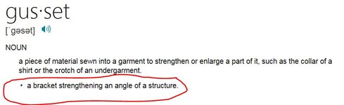

The 40mm dimension (circled in red) does not define the chamfers - it defines the height of the gusset
What is the meaning of gusset? How does it look like?
