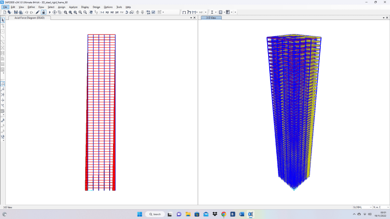

I'm a bit confused and I am hoping someone can help. I thought due to the larger tributary area that an interior column has from the slab above it, therefore it would take more axial load. However, working in SAP2000 the corner columns at the exterior are more heavily axially loaded than the interior columns. Could someone explain to me why this is the case from a structural perspective?

It's a rigid frame tall building system simply under the dead load for the load case.
Here, see the axial force diagram of the left window.

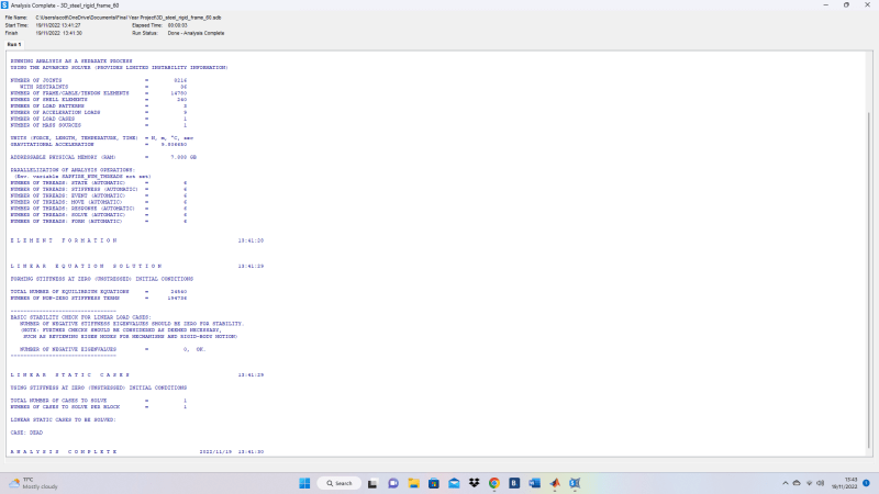

You sure the model is even solving and not spitting out ill condition errors in the analysis log?

@Agent666 - Yes, I have assigned supports under the interior columns as well. I am not quite sure how to check the analysis log.

I think this might be the analysis log:
Seems okay.
If there is no cladding weight, then likely, something is not correct.
Review deflections? Usually that will give you an idea of what doesn't appear right.
Check anything that might affect the axial stiffness, is one of you E values orders of magnitude higher/lower than it should be. Is one of your column sections size defined in the wrong units and much larger than it should be.
What you're seeing appears wrong. Try modelling something similar from scratch, do you observe the same effect or have you inadvertently not made the same mistake somewhere along the way?
