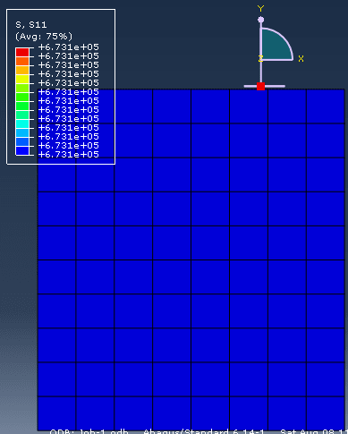

I simply tested a orthotropic x-tension in ABAQUS 2D plane strain with/without subroutine.
The first image groups showed I just inputed these parameters in material.

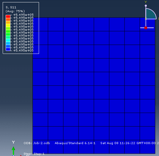

The second image groups showed I use a UMAT to input these parameters.
Besides, I also updated the comparing zip files, which contained different inp files and subroutine fortran file.
