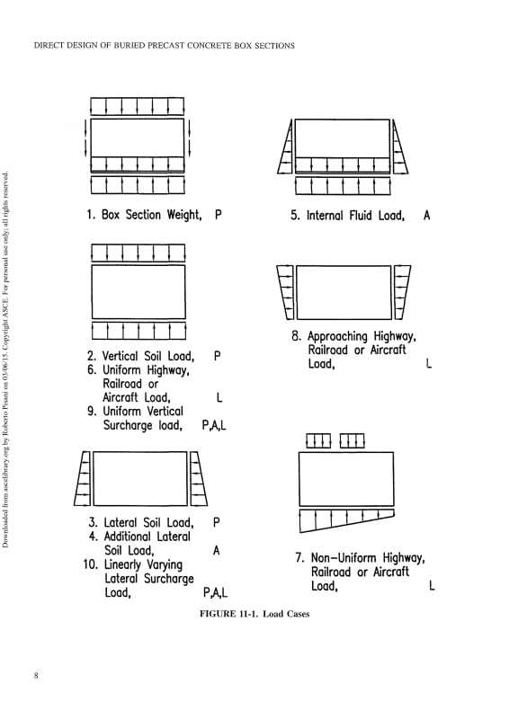

while modelling a 2d box culvert in STAAD Pro what kind of support conditions are required. Is it fixed , pinned or spring support to account for soil stiffness. In case of Spring supports is it necessary to consider the upward reaction by soil or should it be neglected

Is it necessary that the maximum Bending moment in culvert slab shall come at the center section of the slab? and maximum shear force near the support sections.Please solve my query.
- The max. sagging moment should develop , the most likely place is at the center of the slab,
- Develop a FEM model ( the bottom elements are supported on Winkler springs ) and see the effects.
- The loads are overburden , traffic for the top slab and you may assume at rest soil pressure for the walls
