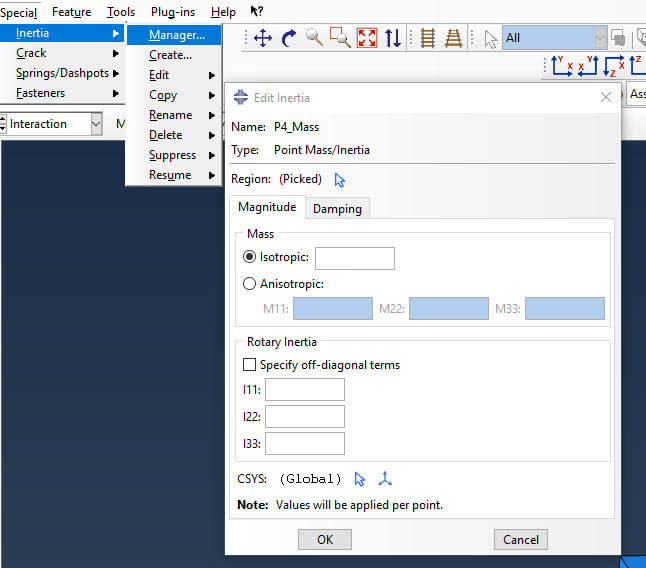

When I add Point mass/Inertia - does it get added from step 0?
rte4563
Sep 28, 2022
40
NO
When I add point mass to my model, does it get added to the initial step and propogates throughout all the steps?
It's not a step-dependent feature, just a type of a finite element so it's active during the whole analysis, like other elements.
