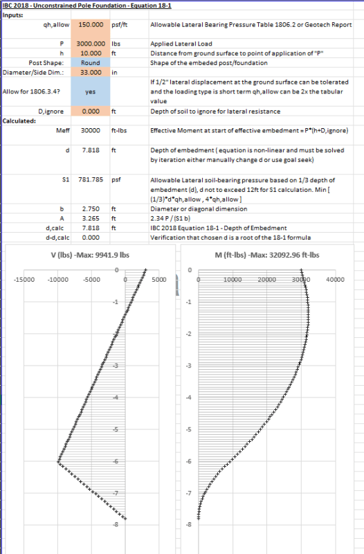

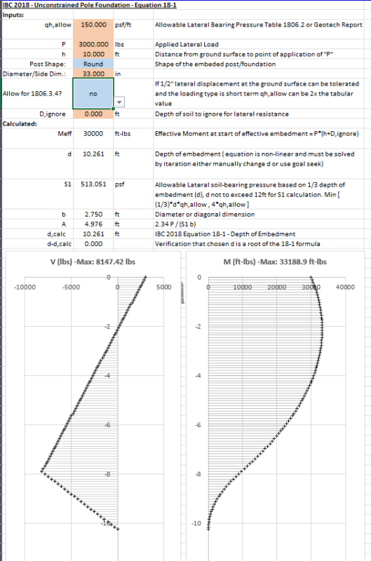

I get a bit worse that 7':
w/1806.3.4:
w/o 1806.3.4:

Celt - slick as usual. I really like the the shear and moment diagrams for the foundation.
Apologies, not sure how to reply to individuals but @Celt, you're correct. I rounded slightly in my original post but 7' works. I have run all the same checks. And yes, I used the 2x increase for 1806.3.4 as well as the 1.33x increase from 1806.1.
