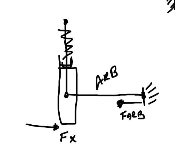

I see, Thanks for the quick reply. I thought the ARB only worked for lateral loads and for curve control, since that's what you hear most of the time, so if I only see it as a quarter model vehicle, would it look something like this?

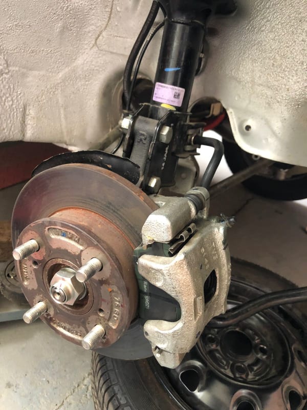

This is the MacPherson suspension of the vehicle I'm guiding, a quite cheap Alto 800.
In the original MacPherson concept, the lateral link was just a link, and the trailing/diagonal part of the ARB also served fore/aft location of the lower ball joint (it connected to the lateral link with a bushing near the end with the ball joint).
Most newer designs use a lower L shaped arm with two bushings on the chassis side, so that it does both the fore/aft and the lateral guidance, and the ARB no longer does anything other than being an ARB.
Yes, but the Alto being the Alto I can believe they reverted to the original design. Worked OK on Mk 1 Escort.

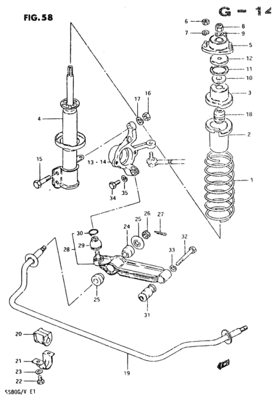

Here you go, Suzuki's illustration looks just like Earle drew it. I've never had the pleasure of designing one of these, the rubber bungs at 24 and 25 have busy lives.

Thanks for the replies, guys! Now it makes sense why this specific suspension doesn't have a drop link. Yeah, I was a little confused because now-a-days vehicles have a lower control arm with 3 points of connection as Brian says and you kind of see where the braking force goes.
