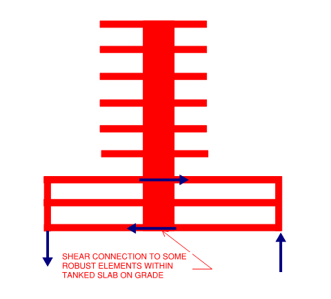

I also like Enhineyero's concept of engaging the substructure globally for overturning. At 6+2, I wonder if one might take advantage of the natural backstay mechanism to achieve that. In concept, it's very much like the virtual outrigger scheme in ultra highrise construction.
