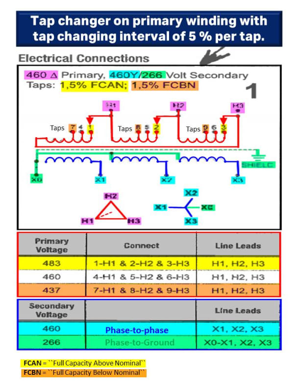

Attached is a cut sheet of the electrical connections for a SOLA isolation transformer.
What is the output voltage if we were to connect our 480V supply to each one of the different taps?
What is the formula?
For example….
Connect the 480V to the 483V tap – what is the calculated value?
What about when we connect our 480V the 460V tap?
What about when we connect 480V to the 437V tap?
What if our input voltage changes to say 490V?
 https://files.engineering.com/getfile.aspx?folder=544b1517-a2d3-4473-9409-6c18b8bb1ef7&file=Isolation_Transformer.pdf
Not much of a formula. It is a winding ratio change, +5%, -5%.
Tap ... Input ... output ... ratio
1 .... 483 ...... 460 .... 0.95
4 .... 460 ...... 460 .... 1.00
7 .... 437 ...... 460 .... 1.05

Ratio H/L: tap 1-2-3 :1.05 (105%)
tap 4-5-6 :1 (100%)
tap 7-8-9 :0.95 (95%)
using the taps, and kwnowing your primary voltage, use the taps closer to your primary voltage to get the secondary one.
So, if you happen to have 483 V at primary, using taps 1-2-3 gives you 480 V at secondary.
Using 490 V as primary voltage results in:
connected on 1-2-3 = 467 V the closest to 460 V (490/1.05)
connected on 4-5-6 = 490 V (490/1)
connected on 7-8-9 = 516 V (490/0.95)
showing why you should use taps 1-2-3.
Output (X1,X2,X3) with 480V supply to H1,H2,H3:
483 tap: 480 x 460/483 = 457.1​
460 tap: 480 x 460/460 = 480​
437 tap: 480 x 460/437 = 505.3​

Below is an edited color version of the connection diagram. I hope the color help to visualize the effect of the taps connection above and below the nominal voltage.
