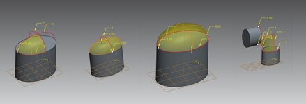

I think you should try it once again. Surface capabilities in ISDX, especially in Creo 2.0 are very high, and advanced.
There are a lot of options not available in direct surface creation tool, but in Surface edit instead.
Try it, play with it, you will be overwhelmed with dozen of posibilities.
In summary, Creo, especially in ISDX can handle 3, 5, or more n-sided surfaces same as SW does.
below you can find how ISDX nadles different types of n-sided siurfs

All of the mothods you illustrate you end up with a 'pinched' mesh as per attached image.

no
all of them are correct 4 sided boundaries
in the first example ISDX makes it prelimenary as ordinary 3-sided boundary, but under options you can switch the surface to 4 sided trimmed rectangle
check the pictures

no
check the pictures

Fantastic! Thats exactly what I'm looking for...
Can you tell me what settings you have switched on so that you can preview the 4 sided quilt? I can tick the 'use for 3 and 4 boundries box' but I'm not getting the mesh preview as you are showing.
