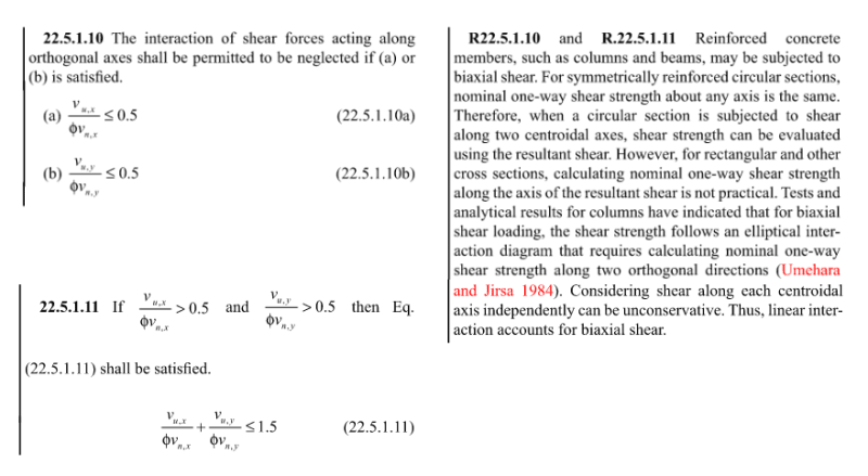

Well it seems ACI318-19 now covers some bi-axial interaction for shear. They suggest you look at it independently, but they don't really seem to explain how the concrete/steel contribution is supposed to be calculated.
I'd still guess working out the concrete contribution on the basis of an effective area of concrete being based on a line that is parallel to the neutral axis but located at 'd' depth is the way to go (similar to BAretired suggestion regarding an odd shaped beam). Use the area of concrete above this line towards the extreme compression fibre as the equivalent area = b_w x d. Then proportion the concrete contribution to each direction. Steel contribution worked out normally on orthogonal axes, using the component of the effective depth in that direction. Carry out the interaction check if you hit any of the limits noted.

Retired13 said:
I believe, design for the larger, or dominate, shear force of the two will satisfy the requirement for both directions.
It seems that ACI 318 disagrees, and so do I.
At each stirrup location the shear crack will still intersect the stirrup at two opposite faces, and the bars on the other two faces won't be doing anything. The active bars won't even be parallel to the direction of the shear force. In the case of two equal components on a square section designing for just one of the components would be like dividing the shear force on a circular section by root 2.

The ACI method is as simple as it looks based on Agent's snippet. I wonder whether the tests were only on squarish sections though.
Update: Umehara and Jirsi tested 300*300mm and 410*230mm columns. 910mm high, so quite stocky. It was related to EQ performance so the stirrups were spaced closely at about 1/5 of effective depth. Seems as though the concrete contribution, which needs to be shared by the two directions, might be a relatively small proportion of the total, compared say with beams that only have minimum shear reo. I haven't read carefully but those are initial thoughts.
