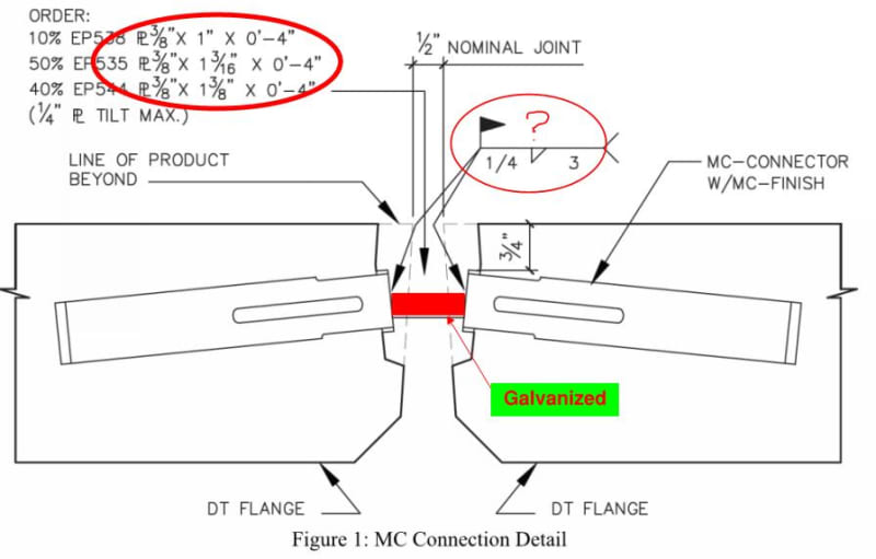

Hello!
This is a typical detail used for the connection of precast concrete double tees.
I wonder if 3/8" loose plate should/can be galvanized.
In my opinion, this galvanized finish will be burnt completely due to high welding temperature
and relatively small plate size.
And, touchup finish like ZRC will be required after welding is done on galvanized plates.
Is it meaningful/worthwhile to use small galvanized plates in this connection?
-JRW
I agree with your concerns. No, it would not be practical to use galvanized plates here.
From my notes:
-IF WELDING OF HDG STEEL IS REQUIRED, REMOVE ALL GALVANIZING FROM AREAS TO BE WELDED TO PROVIDE 1" MIN BASE METAL AROUND ALL WELDS. WORK SHALL BE DONE IN ACCORD WITH AWS RECOMMENDATION WZC. PROVIDE VENTILATION AS REQUIRED. CLEAN FINISHED WELD AND TOUCH UP WITH TWO COATS OF ZINC RICH PRIMER. PRIMER SHALL OVERLAP EXIST GALVANISING BY 1/2" MIN.
-CONFIRM TOPCOAT, IF APPLIED TO HDG, IS COMPATIBLE WITH HDG MATERIAL.

As the max plate width is 1-3/8" wide with a weld on each side, it looks like DIK's notes also agree that they should not be galvanized.
dauwerda, I concur... I should have added a note to the effect galv protection, that to do it properly, it needs space and is a lot of work. There is no reason it should be HDG in the first place. You should grind off HDG, rather than burn it off... dangerous to your health. Even grinding has some risks.

When precast is being erected, it's typically in an outdoor environment and I think those fumes pose little risk.
My last precast job proposed galvanized plate welded to a galvanized embed for a similar situation.
I`m sure they didn't dip this steel just so they could grind it off in the field & I did not take any exception to their proposed detail.

Generally we can weld HDG'd plates whenever we need to as long as we can take safety rule.
In this specific case, steel plates are so small/narrow that HDG'd plates do not make sense
because HDG finish will be lost and another touchup finish will be required.
