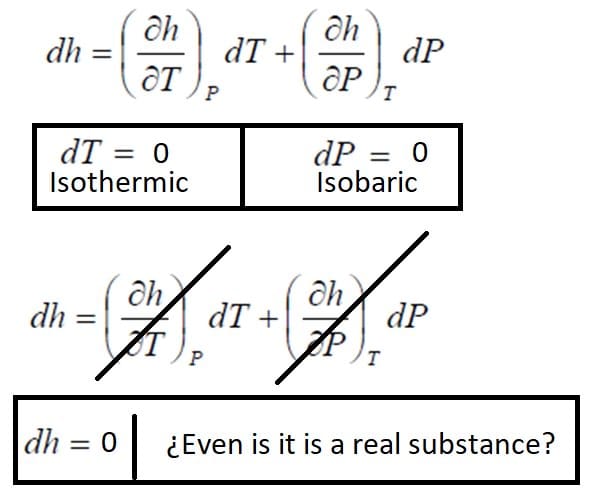

Supposedly the enthalpy would only depend on the temperature and pressure "h (T, P)" or at least this is how commonly enthalpy is expressed in partial derivatives...
So why in an isothermal and isobaric transformation is it different from 0?
*We are taliking of real subtances here, nor ideal gases.
*We know that is non zero!, beacuse we see it all the time on state changes and some chemical reactions.
That equation must be incomplete... or just misleading.
Maybe i'm failing to grasp a mathematical concept that I do not remember.
Please help or guidance.

Yes, to this point I could classify it as a dumb question of mine. But i'm stuck..
There is the catch...
In many phase changes, and in many Chemical Reactions we consider P and T constant. But energy change is obviously non-zero and you really have some enthalpy difference. Work is done by the volume change of the substance.
So that means the h(P;T) derivative notation does not hold all the information? Because dH=0 if I use that partial derivative equation... but there is work done by the change of volume, that do not appears on that equation.
So... V is a totally independent variable of T and P. For a real substance.
The equations you posted assume no chemical or nuclear reactions are involved.

Assume a constant P calorimeter where liquid water is at 100 ºC and is brought to water vapor also to 100ºc with the mixture of a hot fluid. Calculate Q needed. (enthalpy)
*T and P are constant on this process.
*We know also that Hv-Hl=L where "L" is the Latent heat, that indeed is different from 0.
BUT
The problem remains on:
URL]
It certainly does not work here, but ... why???. If there is only a cuastiestatic work (Volume expansion) that equation should work.

The specific issue is with that equation, is a closed system.
The thing comes to dependence between P and T. When there is a phase change or a chemical reaction they become dependent and they do not follow the State Postulate that allows one to write h(T;P).
If I define h(T;v) then I can use that equation on phase changes and chemical reactions without drama.the
If you look further back in the basic premises for this State Postulate in your thermo text, it would state that this equation is for single phase systems with no chemical reactions ?
if it is a single phase gas with no chemical changes then roughly PV=ZRT, if P and T are constant , then T is fixed as well, and H is constant . In 2-phase ( water/steam) situation T and P are constant but H varies as x ( steam by weight ) changes. Multiphase or multicomponent ( as with ammonia -water or binary hydrocarbon) cases will have H vary as phases or chemical componengts change. So it looks as if you are readsing a thermo book and may have forgotten the preface stating the elementary discussion assumes single phase or without chemical reactions.

So that seems to say to me that even if I have a mulphase/multicomponent system enthalpy h of the whole system can always be calculated has h(T,v)? Is that OK?
*I know that h "natural variables" are h(s,P) but it seems that h(T,v) should also work.
**There is no reference to chemical nor phase changes on the book I'm using.
"So that seems to say to me that even if I have a mulphase/multicomponent system enthalpy h of the whole system can always be calculated has h(T,v)? Is that OK?"
No. In a multi-phase system you have another degree of freedom (x, i.e. mol fraction liquid or vapour) and hence you need another state variable. In fact, you will have many more such fractions in multicomponent systems, and each such fraction is another degree of freedom.
"only two independent intensive variables are sufficient to derive all the others by use of an equation of state. In the case of a more complex system, additional variables must be measured in order to solve for the complete state."
Isn't that precisely what your citation says?
