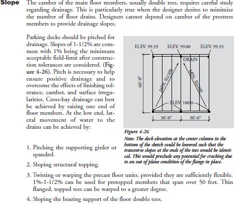

It is typical to get drainage in parking structures by having the bearing around the exterior of the structure level and then dropping one end of an interior beam to create a warped deck. This creates torsional twist in the member but given the slenderness of flange and each of the two stems, they do not have a great deal of tortional stiffness.
I have done a lot of structures with 1" across a 10' tee which puts the bearing 1/2" differential slope.
I am working with an architect that wants 2.75" on a 10' tee which is considerably farther than I have done in past projects. Does anyone have experience or rules of thumb as to how far you can twist a prestressed double tee before you start running into problems?
To be more specific, on a 24" x 10" DT x 47' long, would you be comfortable with both stems bearing at the same elevation on one end and one stem being 1.375" lower elevation at the other?
I would be comfortable if both stems bearing at the same elevation on one end and one stem being 8" lower ( lowest pt ) and the other stem 5" ..
The following excerpt from PCI Parking Structures: Recommended Practice for Design and Construction..

The architect is calling for a girder with a cross slope of 2.2% for the bearing at the center of the structure. The spandrels at the perimeter will all be level. The PCI recommendations are for 1% - 1.5% for pretopped tees. My structure has 2" flanges with 4" cip topping.
It says that on thin flange tees you can go more than 1.5% but does not give any indication as to how much more.

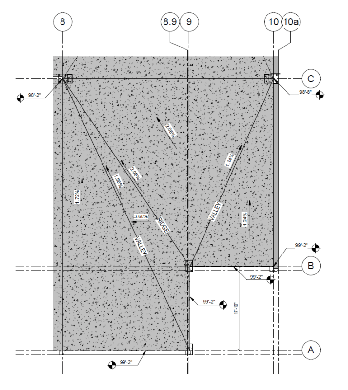

Right now, the architect is calling for 2.2% cross slope which is 12" over the 45' girder length. I would prefer to see the warping between 1% and 1.5% but that would mean about 6" extra topping which adds up to a lot of concrete and additional dead load (and seismic in high SDC D).
I am planning to see if we can drop the whole girder 6" and then the low side an additional 6" which will cut the warp to 1.1% but leave the garage with mostly the same geometry.

This is what I am proposing to the architect.
by dropping the high end of the girder from FF to -6" I cut the warp from 2.2% to 1.1% which feels a lot better.

You might also want to think about what's happening with surface alignment at that re-entrant corner. If you were to ignore camber, that point at B-10 would want to be about 2" lower so the tees left of line 9 are close to flush with those on the right side of line 9 at B-9.
Thanks @Jarm013.
I have been having an internal debate with myself regarding the B/9 corner. In the original layout where the girder on C was at 99'-2" on the right and 98'-2" on the left, the difference in the slope of the 1st long tee to the left of 9/B was at -1¼" below the bearing at 99'-2". That actually worked out pretty darn well because the predicted camber at 17' was +1.29" so very little differential elevation at the junction.
As pointed out, the new scheme will put the left plane about 2" low so I may need to make an adjustment to the bearing on B / 9-10.
