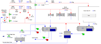

I am currently working on an energy management project focused on an industrial warehouse (pulp). I am trying to understand how the warehouse is heated to estimate the energy used and suggest energy saving measures. From what I understand so far, glycol is heated either by a separate boiler (its operated only in winter) using natural gas or by steam from another boiler. The steam exits the boiler header and splits to serve multiple purposes: production processes, electricity generation, and heating glycol (desuperheating steam).
The hot glycol flows through pipes and splits off to unit heaters, where fans move air across the glycol coils to heat the surrounding air in the warehouse. Additionally, the glycol heats air in air handling units, which recirculate the air, and it also heats air from the makeup air unit.
For controlling warehouse temperature, they rely on an On/Off fan operation with the following control logic:
When the fan switch is set to "AUTO," the fan operates only if the warehouse temperature drops below the set point (7°C).
When the fan switch is set to "ON," the fan runs continuously, regardless of the temperature.
I asked people in the facility they told me they have no other controlling method.
For airflow, I asked whether the building has vents to exhaust air. I was told there are no dedicated vents, so the makeup air from the main air handler simply finds its way out of the building naturally. The warehouse walls are concrete, and the door heaters, mounted above the doors, provide adjustable air curtains with 90° nozzles pointing downward to prevent cold air inflow.
My concern: With no dedicated vents and the present control method won’t the continuous heat addition from glycol lead to a gradual temperature increase in the warehouse?

Look at the heat loss through the walls and roof as a function of temperature difference.
Heat in equals heat out.
When you have solved that, consider heat loss in the air curtains and add that in.
Air curtain loss may be negligible or it may be considerable depending on how often the doors are opened.
And due diligence may suggest checking the temperature of product entering the warehouse.
If the product is above ambient temperature it may be relieving the unit heaters of part of the heating load.

Probably not.
The transfer from the heaters to the air will be much smaller without the fans. This is the reason there are fans.
Self correction:
If the airflow from the fans is horizontal there will be little convection.
If the airflow from the fans is vertical, you may have a slight issue on mild days.

I am attempting to account for the energy flows. Air is introduced into the warehouse via the makeup air unit, and there are no dedicated vents, so the air leaks out naturally. At the same time, cold air infiltrates through cracks in the building envelope.I am attempting to account for the following energy flows:
Heat flow from glycol to air = Heat loss through walls and roof + Heat loss due to warm air leaving the warehouse + Heat loss due to infiltration of cold air.
The air from the makeup air unit keeps the building pressurized during the winter so that air flows outward only through door cracks, etc. and therefore as long as the MAU is operating there is no infiltration of cold air.
The heat flow from the glycol to the air is based on the capacity of the unit heaters. I believe you are concerned when the unit heaters fans are off and you have natural convection. I don't think you can quantify exactly how much heat is loss while continuously circulation when the thermostat is above the 7C setpoint and fans are off. I don't think it would be enough heat to significantly raise the temperature in the warehouse. This is because the design temperature must have been 7C for sizing the unit heaters and determining how many needed. Therefore, the heaters should be just able to maintain the inside temperature at 7C at lowest winter temperatures outside. So at design 7C heat output of heaters equals heat flow out through building walls/envelope. So consider this the design calculated heat flow out through the walls, building envelop at 7C when the heaters are operating with fans on which is the maximum heat input into the building space possible. If the temperature rises above 7C the heater are off, but now there is even more heat transfer to the outside at a higher inside temperature than 7C than even what all the heaters were designed for with fans operating. Since the heaters under convection flow can only output a fraction of the heat as with fan running they will never equal the heat output through the building envelope when the temperature rises above 7C. The only way the temperature can rise inside the building is if the output of the heaters is greater than the heat flow out through the building envelope.
That being said I would put the glycol recirculation pumps on a thermostat control such that they only circulate glycol when temperature outside is say 9C. Not only are you wasting energy through convection at the unit heaters but you are wasting a lot of pumping energy.
Heat loss out through the building envelope can only be reduced by adding more insulation. The make up air unit must operate to provide ventilation air or provide for some make up air requirements for any process equipment. You cannot get rid of this. This air is the only air that exits the building. Theoretically there is no other added load from the MAU other than the heat you put into the heating coils in the unit to keep it at a maximum supply air temperature of 7C. As this air passes to the warehouse and out the cracks theoretically it should not pick up any heat from the unit heaters if the unit heaters are set at 7C also and keep the inside space at 7C approximately.

The air make-up unit appears to be sized for 68,000 cubic meters per hour.
It appears to have thermostatic control that will close the valve on the glycol circulation when the ambient(?) temperature is above 7 degrees C, leaving the unit supplying unheated air. You may wish to verify that that system is still operational.
68,000 cubic meters in equals 68,000 cubic meters of heated air lost per hour.
I would determine the actual delivery rate of the make-up unit. The flow may already be restricted.
I would also attempt to determine the pressure difference between the warehouse and the exterior.
I would convert the actual delivery volume of the make-up air unit to air changes per hour.
With that information to hand, the question is;
Will a lower pressure and fewer air changes per hour be acceptable?
The air flow through the make-up unit may be restricted to reduce the changes per hour.
That said, I’m unsure what to do with the low-pressure steam if it’s not utilized for glycol heating.
Not your problem. Close the steam control valve. (This may be done automatically already)
If you use less steam, the de-superheater will produce less low pressure steam.
This will reduce the steam demand on the boiler and the boiler fuel feed rate will automatically be reduced to compensate.
