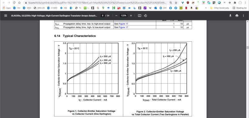

The controls for the motors for our winches have been using a big old, 60 hz. transformer, linear PS for over 15 years. It works fine. I'd like to switch over to an SMPS for the size and the universal input (about 85 VAC to 265 VAC). We use a microcontroller to turn on relays via NPN transistors. I'm looking at making everything 5 volts instead of the 24V/5V we currently use. The transistors, though, drop about .5 volts. I was hoping to use a ULN2003 to replace the individual transistors with a single chip. The ULN2003 (using Darlingtons) drops even more volts (about 1V for I=120 mA). So a 5 Volt PS won't quite cut it with the 5 volt relays I want to use.

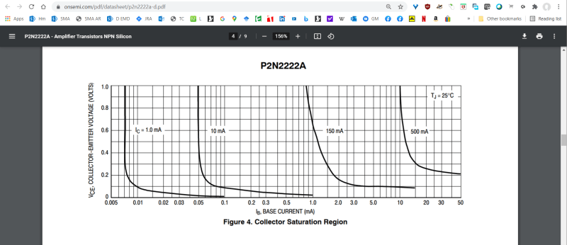

There are many products already marketed that use 5V logic and drive 5V relay coils so you're trying to fix a problem that doesn't exist. I suggest you look at the minimum pick-up voltage for the relay you are using. Also, a NPN transistor drops about 0.2V collector to emitter.
Good point LionelH - I had it in my mind that pickup was about 90% of rated. For the units I want to use it's actually 75%. Five volts should work fine.
Only if you're not using a crappy NPN:

Do you know of any 6 channel arrays (about 120 mA/Channel) with low Vce? It's not a killer to stay with the discreet transistors but an array would be nice.
