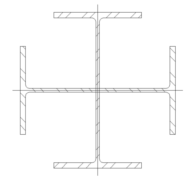

Are you looking at something like:

Concur with 3DD... Is the cruciform section in the middle? You might be better served using an HSS 10x10 or 12x12... Cruciform W sections have very poor torsional resistance. and I can see the web of the cut beams in compression and prone to buckling, giving rise to a twisting motion as 3DD notes.
dik, the cruciform section is the plain X-shaped section the top of which is where the bottom flange of the W-beam would be. What you see in the middle is simply the web of the beam exposed.

dik, I'll look into the hollow section for the column. The reason for the cruciform section, besides integration with the beam, is a chamfered cube at the capital (bigger section) with concrete forming the cube and the steel plates making the chamfers at the edges.
