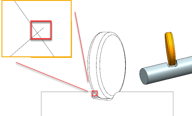

The example below is two cylinders at an angle in between . The cylinders do not touch.
the tolerance is what NX defaulted to.
The wire frame view looks good, no visible errors.
But, when i zoom ridiculously , a tiny error will become visible, but, the paper print of this will be perfect. NO errors visible.
this error is when measured using the "screen distance" ~11 μm.

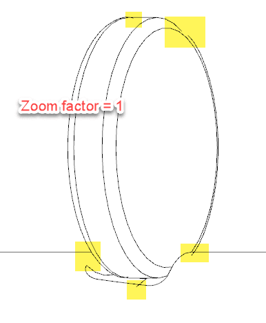

The same view, screen captured with zoom factor = 1. ( which should be pretty similar to printed)
the view tolerance is manually set to 2.
