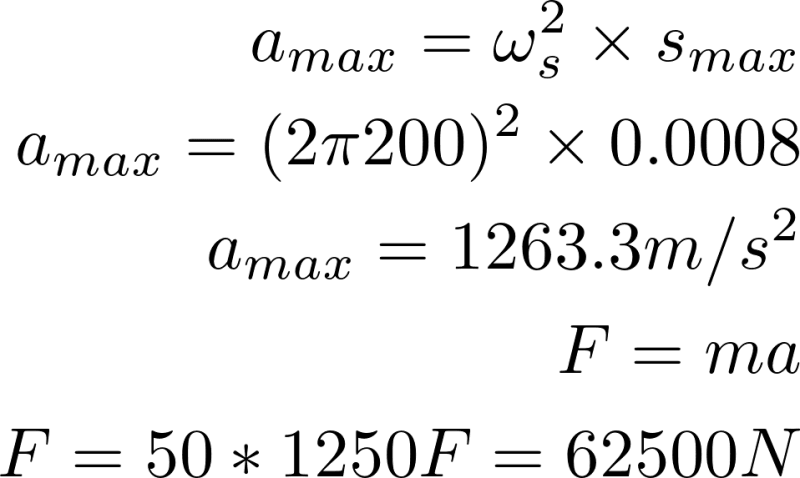

I need to design a vibration table (approx. 1000x1000m) to test products between 7-200Hz. I was wondering if it is recommended to make the table structure from standarised, extruded aluminium profiles bolted together to reduced the cost (material + time) or does one have to go with a welded structure?
Yes, I am aware of the results of the Junker vibration test with regards to bolted connections and it seems like a bad idea, because all the fasteners would loosen. However, maybe there is a workaround to use these aluminium profiles?
I sincerely appreciate any advice and/or previous experiences with these.
Thank you for all the answers -> I have just realised what a complex problem this is given how the professional equipment looks like:
Nevertless, we will be building something much simpler just to test our DUTs, even if it will be a mediocre approximation.
