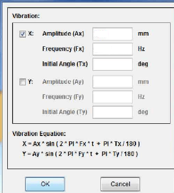

Hi everyone, I am trying to realise elliptical vibration of my tool but I dont know if ABAQUS has a direct way to do it like AdvantEdge (as shown below).
Currently in ABAQUS, im using Tabular in Amplitude for both x and y and input amplitude for each small time step to realise elliptical motion. I wonder if there is a better/faster way to do that. Thank you very much.
This could be also done with subroutines but I don’t think that it would be easier or faster than regular approach with amplitudes.
Okay thank you very much for your information, FEA way.
