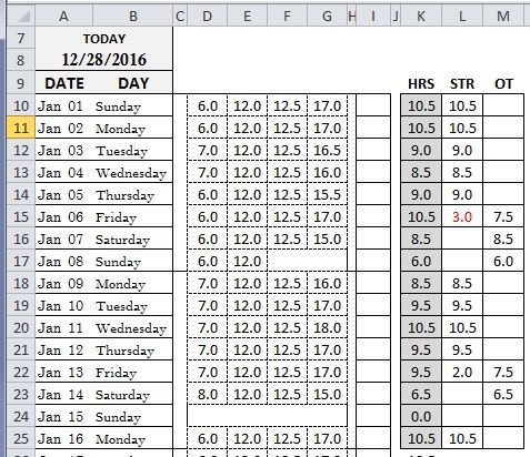

I am looking to make a module(s) that will help me keep track of hours worked each week. The pic below is the basic idea of my format. Specifically, what I am looking for is what will come up in columns L and M in the pic.
*Each w starts on Monday and ends on Sunday.
In column L, it will display the STRAIGHT time hours for each day.
In column M, it will display only the OVERTIME hours for each day. (anything over 40 hours for the week)
In Column K, I already have the formula .... =SUM(IF(E10>D10,E10-D10,"0"))+(IF(G10>F10,G10-F10,"0"))-I10 .... The code for L & M can recalculate the punch in and punch out times, or it can be derived from the totals of column K, whatever is easiest, I will work with.
NOTE: If you can do this with simple formulas that can be copied down the two columns, that would work for me too. I just figured this might be easier to write VBA code for if you know it. I have been struggling to learn it for a while and my understanding of VB and VBA code is coming very slowly. Veeeeerrryyyyy sllooooo lol It may be hindering me that I am trying to learn both at the same time. Not sure.
if this is not too difficult and you can help me with this, it will be greatly appreciated, as not only will it get me what I need, but it will give me more code to read and understand and learn from. :eek:)
Please ignore the fact one number is red.
Hope everyone had a wonderful Christmas and has a great New Year.
Hello,
If you can add two columns (to make this easier) then you can do the following:
In N10 enter this formula:
=WEEKNUM(C10,2)
In O10 enter this formula:
=SUMIF($N$10:N10,WEEKNUM(C10,2),$K$10:K10)
In L10 enter this formula:
=IF(O10>40,K10-M10,K10)
In M10 enter this formula:
=IF(AND(N9>40,O10>40),K10,IF(O10>40,O10-40,0))
copy these down as far as required.
There is probably a simpler solution, but not the best as time calculations. However, this does give the same results as your post.
You could combine the 'extra' formulas into cols L & M.
Hope this helps.

Thanks for the help. At first these did not work, but I realized you were naming cell C10 in a couple of the formulas and that cell is empty at this time. I assumed you meant A10 to get the day of the week? This seemed to work at first but when I dragged it down, I the STR column (L) would continue to give amounts after it totaled 40 hours for the week, only the amounts returned were a negative of the cell one up in the L column.
I was able to fix this by making the formula in "L10" to be....
=IF(IF(O10>40,K10-M10,K10)<0,"",IF(O10>40,K10-M10,K10))
So that if it became a negative number, it would return as a blank cell.
For M10, I changed the "0" return to "" as well to get my preferred results....
=IF(AND(N9>40,O10>40),K10,IF(O10>40,O10-40,""))
I get the feeling there is an easier and cleaner way. Most likely with a VBA code, but this gets the job done. If in playing with it I find a cleaner way, I will post it.

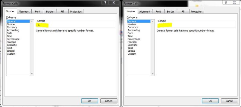

Interesting. So I found why I was getting negative numbers. The code in your post above for M10 ... =IF(AND(N9>40,O10>40),K10,IF(O10>40,O10-40,0)) .... has an N9. In the file you loaded for me, the cells below that all have O10, O11 instead of N10 and N11. So when I copied it and pasted it with the N and dragged it down, it gave me a negative number.
The interesting thing is that I found why I need to use the "" to get a blank cell and you dont. I showed the formatting for the same cell for each of our files in the pic below. I just have no idea why its like this and how to fix it. lol
Hello,
Oops. Just spotted that. The formula in M10 should be:
=IF(AND(O9>40,O10>40),K10,IF(O10>40,O10-40,0))
copy this down as far as required.
The reason I have blank cells, is that in the FILE, OPTIONS, ADVANCED. Display Options for this Worksheet, I have unchecked the display zeros.
Does it work as expected?

Wow, I even looked in the options for that, expecting it had to be there and couldnt find it. Im guessing it was one of my brighter moments and I didnt realize at the time that the advanced area can be scrolled down. lol
