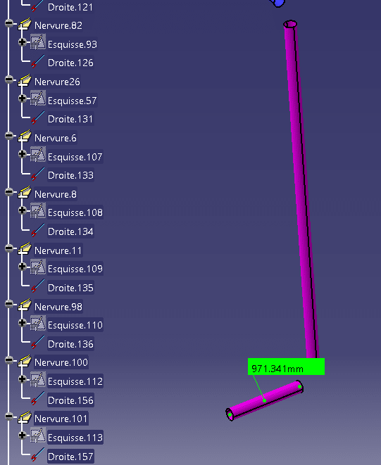

I have a big hydraulic circuit in a CATpart where every pipe are made with a rib.
I'm working on a macro but I'm really newbie in VB for Catia. The aims of this macro are:
-Renumber the ribs and their parent lines
-Measure the lines lengths in X, Y and Z directions
-Export these data to an excel sheet
By now, I only succeed to renumber the ribs.
I don't succeed to modify the parent line number.
Could you help me please?

Pierre
according to v5automation.chm a rib object is a subclass of the sweep object
sweep.CenterCurveElement returns or set the center curve as Reference...
