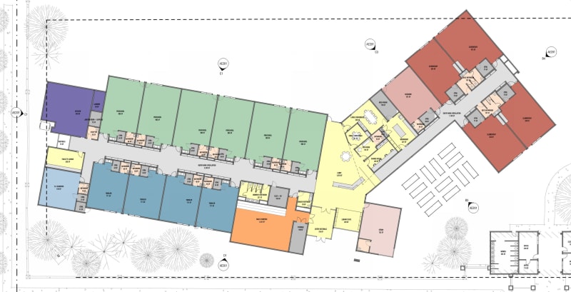

I am currently trying to provide a heating/cooling option to a client that is a little better and not much more expensive than a whole bunch of packaged dx/gas RTU's. My thoughts were to provide an air handler with VAV's and not terminal reheat. All of the heating and cooling would be done at the air handler and the VAVs would just modulate their dampers. I realize that this will not allow for cooling and heating simultaneously to the spaces but are there any major issues I am missing here? I have not ever seen this design implemented in a project and I'm a bit worried that there is a reason for that. Thank you!

You will need to have perimeter heating if you want to do it this way with one unit serving a whole floor that includes interior and exterior zones. So in summer they all get cold air, in winter they all get cold air, but perimeter spaces have their VAV boxes at a minimum, and the perimeter heating handles the envelope load plus the small amount of unwanted cooling from the ventilation.
Just imagine the dead of winter - you’ll have every perimeter space needing 90 degree air, and ever interior space will still just need cooling at 55. Whichever one you pick, you’ll have a lot of people upset
The way your setup you described works is if every room you have served by the air handler is either all interior or all exterior spaces.

Thanks GT-EGR, I'm starting to understand why I don't see these systems. However, almost every room is an exterior space (see image). I think we'll just need a split for the AV closet, an RTU for the kitchen and an RTU for the conference room area but other than that, it may work out quite well. I'll show the supply diffusers on the exterior walls for the main rooms.

Since most part of the building will require heating in winter,a central VAV AHU with terminal heat does not seem to be appropriate solution. Separate systems for perimeter and internal zones seems to be the way to go.
The option that comes to my mind - Packaged units with terminal reheat, but grouping some of the classrooms with the same exterior exposure directions. If there's a kitchen, you'll probably need to keep that separate - exhaust requirements, varied exhaust? So maybe 3 or 4 rooftop units. I would then provide supply slots at the windows and a single 2'x2' supply diffuser in the rooms. Have about half the required room air going to each slot.
