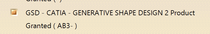

Check your licenses (Tools + Options) and make sure you have the GSD2 (Generative Shape Desgn 2) license.
I think the Variable Radius Fillet is an "advanced" tool.
I have GSD granted but still don't have that functionality working. Is this what you meant?
Yes, that's the correct license. Are you using the GSD workbench?

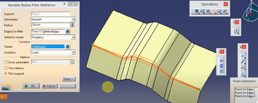

This is what I am trying to do (image is from a youtube tutorial):

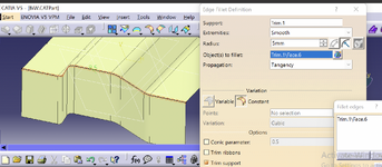

But when I try to do the same, I can only select a surface as support, and then not able to select any additional points to make a variable radius fillet. The mouse pointer turns into that black circle with a line through it. Below image is from my computer:

What am I doing incorrectly in the second image? Could it be something wrong from Swept Surface or Trims?
are you using the Body In White workbench?
I've tried Part Design and Generative Shape Design workbenches only
