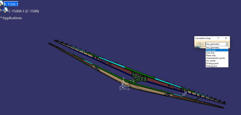

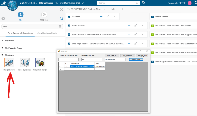

It's still in CATIA, but very well hidden [bigsmile], I had to use my app to find where is it...
2020-06-25_14_52_14-V5_Cumulative_Snap_function_in_3DX_Catia_-_DASSAULT__CATIA_products_-_Eng-Tips_rbgjx6.jpg
Regards
Fernando
