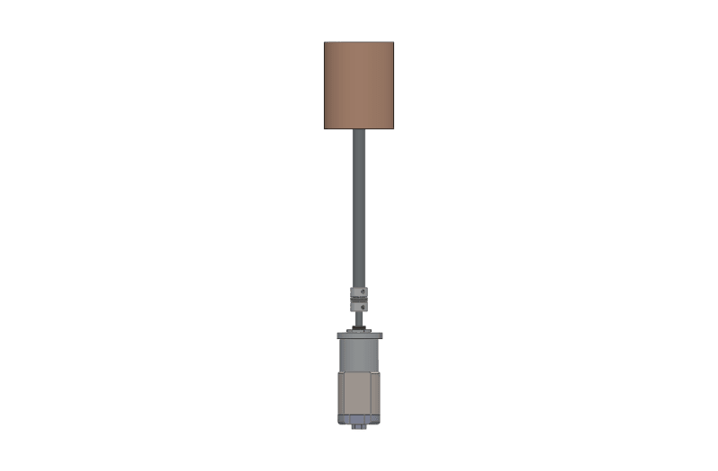

Hello everyone,
I am intending on buying a brushless DC motor and use it as a generator to get the electrical output from a 7mm rotating shaft by coupling it with the motor. I need to somehow test the power output at different rotational speeds of the shaft. Is there anyway or kind of brushless DC motor that can somehow control the rpm or do I have to use a mechanical break? Any advice would be highly appreciated.

So, start over again and tell us, in the words you would use to describe to a fellow mechanical engineer, the following very simple facts:
1. What makes the vertical long shaft in your 20 May 19 19:55 drawing rotate?
2. At what speed does it rotate?
3. If speed varies - what are the upper and lower limits for the speed?
4. What torque is available from the shaft?
5. By controlling, do you mean "take command over" i.e. influence the speed? Or do you mean check/measure/log/record/whatever the speed? Or both (measuring AND controlling the speed)?
6. When you say (16 May 19 19:22) 50 - 100 W. Where did you get those numbers? From other measurements? Or a nameplate somewhere? Or is it a guess or, perhaps, what you wish that you can get?
7. What are you going to use that power for? This is not a totally irrelevant question. The answer may guide you or us to better understanding.
8. Does this contraption exist IRL? If so, make a photograph and show us. It is easy, click the camera icon and drop the picture there.
As I said, you seem to be an honest guy. But sometimes, honesty is not enough. Basic engineering knowledge and some respect for facts is also needed. Or you may end as the President of a mighty Western country.

just to clarify, the copper coloured box is the prime mover which rotating freely. Assume it's a turbine driven by water or air where I cannot essentially control the speed of that rotation. Now if I simply connect a shaft only to the copper box and nothing else at all it will rotate freely at 200rpm (for argument sake). I cannot do anything to change the source of the rotation. The purpose of the motor is to get the mechanical input from the shaft and get an electrical output.
sparweb,
thank you for your reply, your second guess is close to what I am looking for. I essentially just want a way to control the rotational speed, doesn't have be the motor itself, but I wanted to check if that's possible. clearly, it seems from all the replies that it is not the best option.
Skogsugraa,
I appreciate your interest in the problem and taking the time to inquire about it, I genuinely do.
to answer your some of your questions
1- the shaft is connected to a water turbine that rotates due to water stream at a roughly fixed speed, again for argument sake say it's 200rpm. I cannot control the source of the rotation directly and that's the main problem. sharing the whole design will probably add to the confusion.
2- around 200rpm, it will be approximately fixed at that speed.
3- The variation is very insignificant and you can assume it's zero, because I am doing it under controlled conditions.
4- that I have yet to test, but I could check on that and get back to you.
5- by control I mean take command of the speed. assume the shaft is not connected to a motor, in that case it will rotate indefinitely at 200rpm. What I would ideally like to do is for example change that rotational speed to 180rpm or 150rpm or so on. I do not have to do it very precisely, I can measure the rpm easily, controlling it is the challange. It doesn't have to be done through the motor, any other suggestions are highly appreciated.
6- 50W to 100W is a guess based on a similar design of similar size, properties and test conditions made elsewhere. I cannot be 100% sure that will be my output but it's a fair guess.
7- I am not planning to use the power for anything at this stage, I just wish to measure and record it to better understand the potential of the design. So I will likely connect the motor to a multimeter.
8- Unfortunately it does not exit at the moment.
please let me know if I can clarify on anything else.
Thanks.

Very good, AJ2!
But you were driving us crazy. Braking a shaft with a DC motor is very easy. Couple a big enough motor to the shaft - as you said - but you started talking about a brushless DC motor. Then get a set of incandescent lamps with a suitable voltage and connect them to the motor/generator output and see the speed drop as you connect more and more of them. You can also use a rheostat (a variable power resistor) for the same result. Or, if you have a separately excited motor, keep resistance constant and go from zero excitation current and up. That will increase voltage of the DC machine and hence the load on the shaft.
Or use a mechanical brake, which you know more about than I do.

A used automotive alternator may fit the bill.
It should easily handle the power that you are expecting.
Remove the voltage regulator and control the field directly.
The automotive alternator will generate an AC potential but will internally rectify the AC to DC.
Connect a resistive load to the output terminal.
Start your prime mover and slowly increase the voltage applied to the field.
As the field voltage is increased and the field is strengthened, the output voltage will increase.
As the output voltage increases, the current through the load will increase.
Volts time Amps will give you the power in Watts that you are producing.
You may have to increase the speed of the alternator with pulleys and a belt.
As you increase the voltage applied to the field, the output will increase until you stall the prime mover, burn out the alternator or burn out the alternator field.
You will want a variable source of DC from zero to about 14 volts for the field.
If you can get this set up, come back and we will help you tweak it.

thank you, the exactly the kind of answer I was looking for. I think your suggestion is probably the most straightforward way to go about this. Hopefully it will work and I won't have to resort to the mechanical breaking system I have which I'm fairly certain will work, but it causes a lot of major inconveniences outside the scope of this post. Also, no worries, your previous comments are probably for the best
Bill,
many thanks for your detailed suggestion, I will have a go at skogrussa's idea and if that prove challenging I will certainly try to set up the automotive alternator. Don't be too surprised if you see me back here soon.
