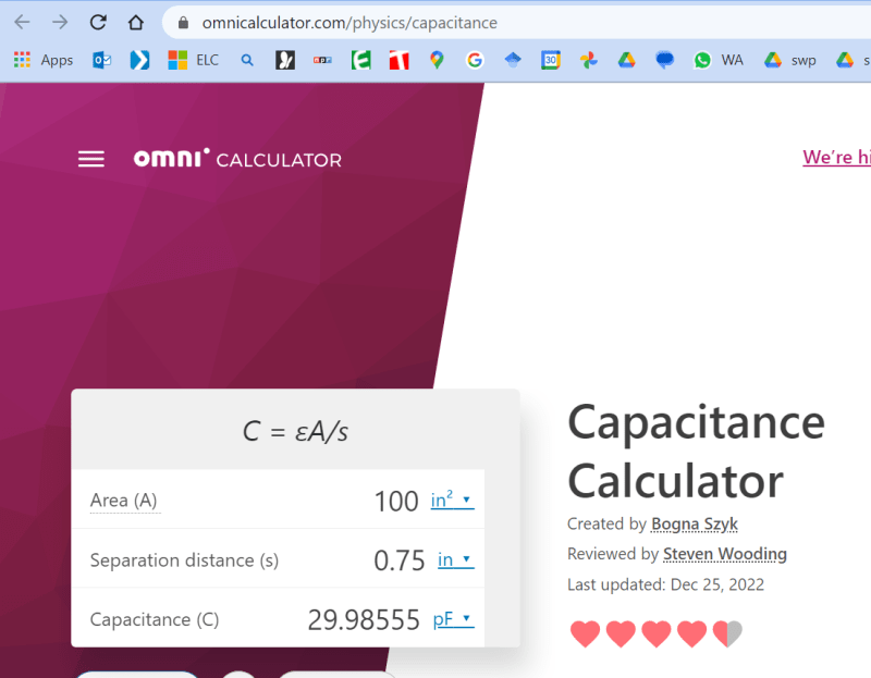

You apparently haven't even attempted to do ANY analysis. Your Arduino is unlikely to be able to give you much accuracy, given the capacitance below.

Maybe - this claims a circuit to go to 1pF -> though that's a lot of area for a sensor.
TI already makes a sensor for this application and the above breakout board works with a much smaller area. The FDC1004 claims 0.5 fF resolution.
I think the main error here is the belief that there is an analog stage that has a high-level signal amplifier in the switches that can easily be adapted.
The prototypical Arduino processor, the Atmega 328P has a 6 channel, 10bit A/D capability (I think it is one convertor with 6 way switching) so it could do some of it, just not without help from a resistor or two.
It is also clearly not a great way to measure distance.
