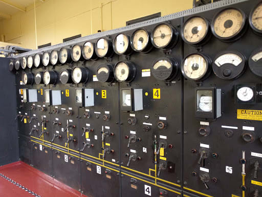

Waross, when I joined my company in 2007/2008 we still had two small hydro plants from 1898 and 1904 that were entirely manual - I ended up putting the very first PLC in one of them (as well as the first sync check relay believe it or not) Watching the operator put a unit online entirely manually was pretty cool and educational for a new engineer.
